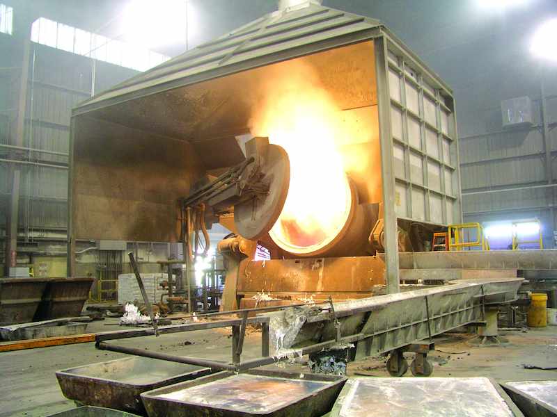

Few industrial processes consume energy at the scale of metal melting equipment. According to a recent DOE study, the metal castings industry uses about 55% of its energy in metal melting alone. Ferrous and non-ferrous scrap metal reprocessing facilities and specialty steel smelters use similar large proportions.

One major source for energy recovery is in combustion exhausts. Whether coal, coke or natural gas are the fuels, with existing technology much of the process heat goes up the stack. Recuperation or regeneration systems are practical tools for recovery of this heat. The recovered heat in turn can be used for pre-heating combustion air, or in some cases for preheating the furnace charge materials such as scrap metal or ingots.
Oxygen – in Limited Amounts
A second important tool for many metal operations is oxy-fuel firing. Current burner technology allows introduction of a controlled amount of oxygen for combustion, which makes a hotter flame and quicker melt. The more quickly metal gets to the molten stage, the less energy is needed. But tight controls on oxygen levels are also important, because for some metals – especially aluminum – excess oxygen causes metal oxidation and a lower economic yield of molten metal. For these applications, increasing the oxygen level from the atmospheric 21% to perhaps 30% or 35% may be the optimum. Beyond this, the waste of metal becomes unacceptable.
