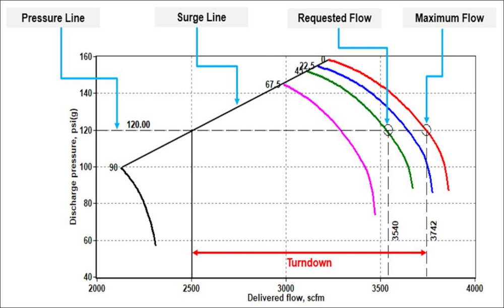

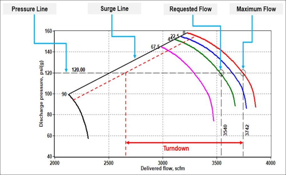

Figure 1 depicts a standard performance curve with pressure line, surge line, requested flow, maximum flow, Inlet Guide Vane (IGV) positions and turndown. Pres­sure line is the operating pressure, requested flow is anticipated required flow, maximum flow is peak com­pressor output at operating pressure and surge line is the natural surge of the unit at operating pressure. Natural surge – the point on the curve where the surge line crosses the pressure line – is to be avoided, as it is the point where flow reverses, possibly damaging the com­pressor. The curved colored lines show IGV positions by angle, with 90° being fully shut, 45° being half open, and 0° fully open. Minimum flow is the point where the natural surge line crosses the pressure line, in this case 2,500 scfm @ 120 psig.
Figure 1: Typical Centrifugal Performance Curve with Surge Line and Turndown. Courtesy: Atlas Copco Compressors

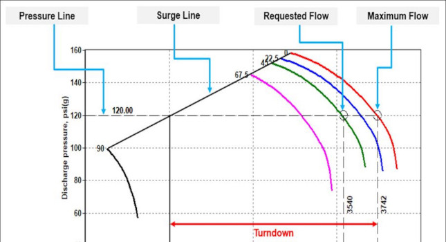

During commissioning, a control line will be set up to protect the compressor from natural surge. The IGV will throttle shut as pressure rises (flow drops). Once the compressor reaches maximum turndown, the blowoff valve will begin to open in order to prevent the com­pressor from surging.
In Figure 2, the point where the red dotted line (con­trol line, just below the natural surge line) crosses the pressure line illustrates the new, site-adjusted blowoff point. It’s common to set the control line 5-8% below the natural surge line. Job site turndown percentage and blowoff flow point will be less than what is shown on a standard performance curve. Jobsite blowoff point is now approximately 2,650-scfm @ 120-psig.
Figure 2: Centrifugal Performance Curve Showing Control Line and Turndown Flow (red dotted lines). Courtesy: Atlas Copco Compressors

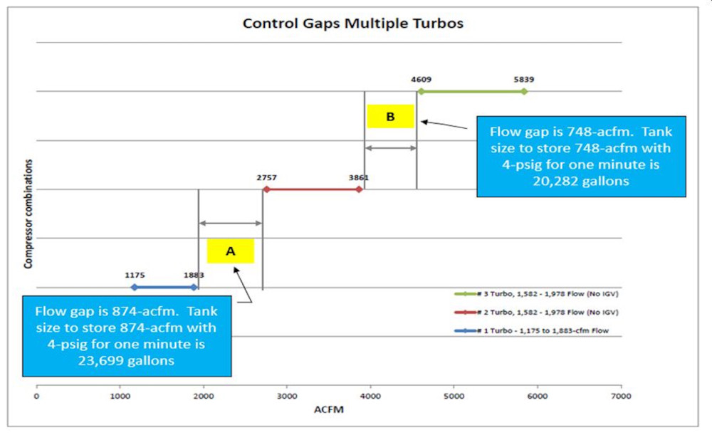

Control gaps exist in nearly all compressed air systems. A control gap is a flow window where demand is too low for the trim compressor to run without blowing off, but too high for it to unload and shut down. Eliminat­ing control gaps from your system can be difficult. It’s important to understand where they exist, and why. Understanding control gaps will enable plant personnel to choose replacement equipment and system improve­ments that may eliminate gaps.
Control gaps for centrifugal compressors are sometimes more difficult to eliminate than they are in rotary screw systems, especially when all the compressors are rated for similar flows. Utilizing compressors of various capacities and operating pressures can reduce or eliminate gaps.
Fully understanding the plant flow and pressure profile is key to unlocking solutions. Figure 4 shows flow gaps in a system with three centrifugal compressors. One unit is new with an inlet valve utilizing IGV’s, and two are older units using butterfly-style inlet valves. The turndown range of a centrifugal compressor utilizing IGV’s on the inlet is considerably wider than on a unit with a butterfly inlet. A and B show the flow gap where #3 Turbo would be running in blowoff, and the tank volume required to store the flow gap cfm for one minute. Pressure bandwidth on turbo compressors is typically low, therefore the storage volume required to cover a flow gap for only one minute is generally large, as illustrated.
Figure 4: Compressor Control Gaps with 3 Centrifugal Compressors. Courtesy: Atlas Copco Compressors

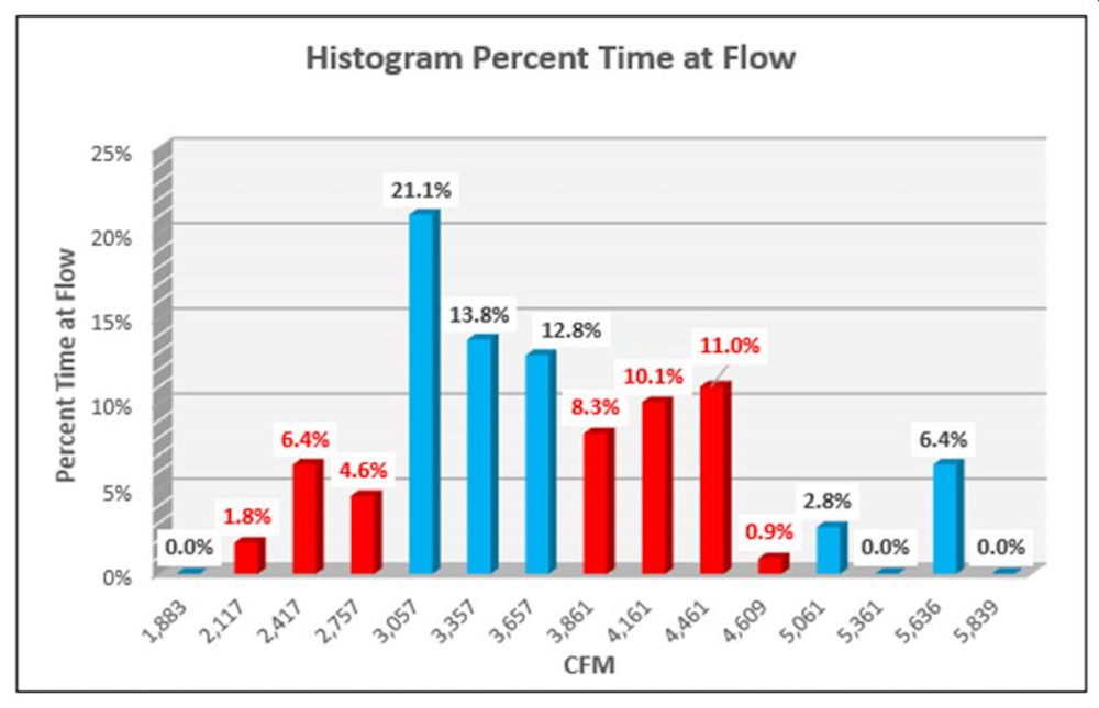

Figure 5 is a histogram illustrating the system demand profile as percentage of time in various flow windows. Histograms are useful for identifying flow gaps, where system compressors and local controllers are not capable of efficiently meeting system demand. This can waste a tremendous amount of energy. Thorough analysis of the flow profile allows for correctly sizing new or replace­ment compressors. Figure 5 shows minimum through maximum flow, in 300 cfm windows.
Figure 5: Histogram Showing Percentage of Time in Various Flow Ranges. Courtesy: Atlas Copco Compressors
Figure 5 illustrates how often the equipment listed in Figure 4 is in blowoff (red bars). In flow gap A, #2 turbo is blowing off 12.8% of the time. In flow gap B, #3 turbo is blowing off 30.3% of the time. This system, as currently configured, is blowing off and wasting energy 43.1% of the time.

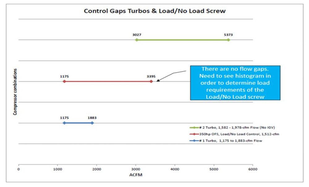

Figure 6 displays control range in the same system with two centrifugal compressors and one load/no load rotary screw. The graph shows no flow gaps, however that can be somewhat misleading. The screw compressor could have a high cycle interval or be running in unloaded condition. The histogram in Figure 5 will help determine if the fixed-speed screw is the right choice for the system.
Figure 6: Compressor Control Gaps with Two Centrifugal Compressors & 1 Load/No Load Screw. Courtesy: Atlas Copco Compressors

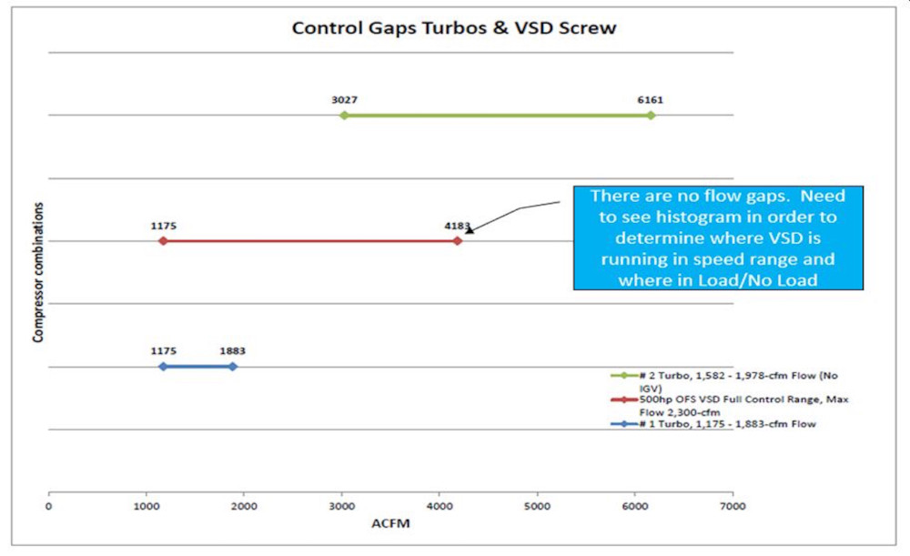

Figure 7 shows control range in the same system with two centrifugal compressors and one VSD screw. The graph shows no flow gaps, but that also can be misleading. The VSD screw compressor could be running in start/stop if trim demand is below mini­mum flow (speed). Compressor control design could impact performance near the minimum flow range of the compressor. Some VSD screws operate in load/ no load below minimum flow, therefore providing a wider range of capacity resulting in increased effi­ciency. Again, using the histogram showing time at flow will help determine which type of VSD screw is the right choice for the system.
Figure 7: Compressor Control Gaps with Two Centrifugal Compressors & One VSD Screw. Courtesy: Atlas Copco Compressors
