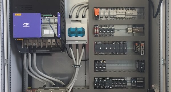

One Italian industrial automation control systems supplier, for example, has significantly cut energy and maintenance costs in the use of an industrial shredder by introducing a VFD into its process.
High electrical absorption was being created on start-up by an existing star/delta starter. This, combined with a lack of motor speed control, was creating high energy costs and wear on the blades of the shredder. The motor control was a particular issue as this meant the speed of the cutting blades couldn’t be adjusted to match the type of material being shredded. This resulted in wear and damage to the blades. As a result, they needed to be regularly repaired or replaced.
The decision was made to change the existing main line fed Star/Delta starter for a VFD. Straight away it was possible to accurately control the speed of the motor, resulting in reduced energy use. A range of materials were shredded and there was immediately much less wear or damage. Importantly, the previous high absorption resulting from star/delta starter was reduced, cutting energy costs for the plant.
