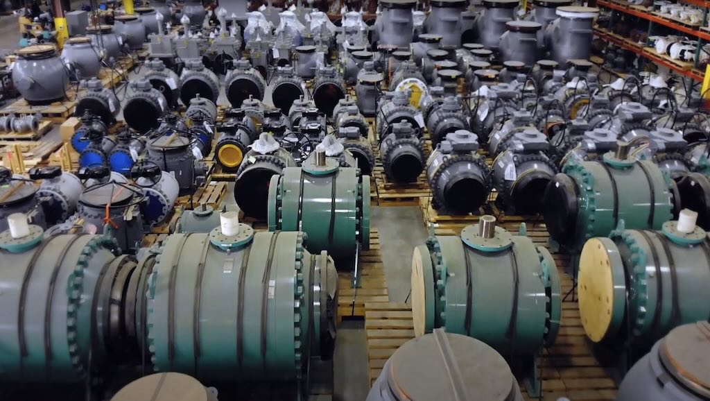

Installing pressure relief valves in high-risk areas of a fluid system will enhance facility safety and prevent unforeseen downtime (see Figure 1). Venting excess pressure prevents blowouts, equipment damage or complete system failure and relief valves play a vital role in maintaining system pressures within acceptable limits.
Figure 1: Pressurized process fluid systems featuring industrial pumps are prime candidates for pressure relief valves to prevent blowouts, equipment damage or complete system failure.
Figure 1: Pressurized process fluid systems featuring industrial pumps are prime candidates for pressure relief valves to prevent blowouts, equipment damage or complete system failure. Courtesy: Swagelok Co.

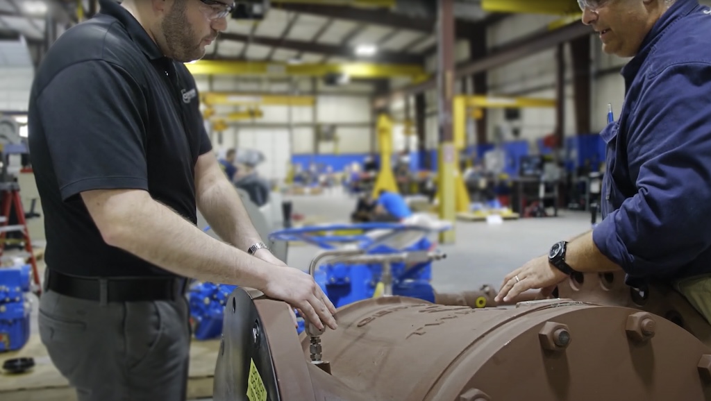

Reliable relief valves are essential for keeping industrial fluid systems operating at peak performance. Finding a supplier that produces high-quality components and can commit to servicing them when necessary can prevent unnecessary downtime and eliminate leaks, keeping facilities and employees safe from harm (see Figure 2).
Figure 2: Coordinating with a reliable valve supplier to determine the appropriate relief valves to use for an application and where to install them will help system designers prevent unnecessary downtime and eliminate leaks for safer operations.
Figure 2: Coordinating with a reliable valve supplier to determine the appropriate relief valves to use for an application and where to install them will help system designers prevent unnecessary downtime and eliminate leaks for safer operations. Courtesy: Swagelok Co.

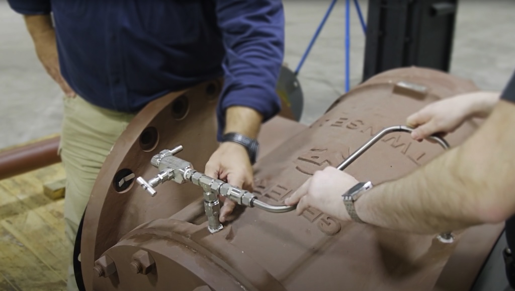

Proportional relief valves (PRV): PRVs provide overpressure protection with a variety of set pressures available (see Figure 3). They open gradually as the pressure increases and close when system pressure falls below the set pressure, with the resealing pressure always being lower than the set pressure. Consequently, they do not have a capacity rating at a given pressure rise (accumulation) and they are not certified to American Society of Mechanical Engineers or any other codes.
Some system applications require relief valves to meet specific safety codes. The system designer and user must determine when such codes apply and whether these relief valves conform to them. PRVs often come in a variety of set spring pressure ranges with the selected set pressure factory-set, tested, locked and tagged to ensure the desired setting.
Figure 3: The proportional relief valve installed on this large process valve will open gradually as the pressure increases over the valve’s set pressure to prevent overpressurization.
Figure 3: The proportional relief valve installed on this large process valve will open gradually as the pressure increases over the valve’s set pressure to prevent overpressurization. Courtesy: Swagelok Co.
