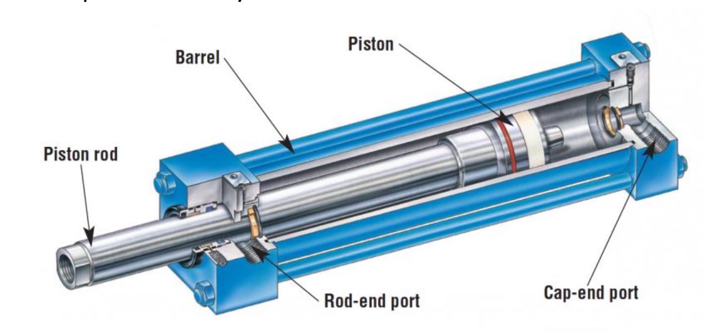

Actuators are used to move or hold products, or to exert a force against it, such as in a press. Pneumatic and hydraulic actuators are typically cylindrical in shape, and so are called cylinders. Cylinders operate by means of the fluid (air or hydraulic) exerting force against a piston attached to a rod. Figure 1 shows a typical cylinder with two ports; when air enters the cap-end port, the cylinder extends, and when it enters the other port and exhausts from the back or cap-end port it retracts. Actuators such as parallel grippers (Figure 2) may also have internal gearing or other mechanisms built in.
Figure 1. Example of a pneumatic cylinder. Courtesy: Automation LLC
Figure 1: Example of a pneumatic cylinder. Courtesy: Automation LLC
The speed and pressure at which the air enters and exits the ports controls the way the cylinder operates. The cross-sectional area and volume of the cylinder also helps determine the force and speed of the rod. The formula for the force exerted by a piston is F = P x A, where P is the air or fluid pressure exposed to the rod, and A is the area of the cylinder face. There are many possible factors that affect this force calculation, consult a good pneumatics reference if exact calculations are needed.

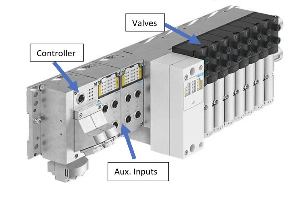

Valves are often arranged in groups on a manifold. This allows multiple devices to be controlled with one centralized air supply and control connection. The control may use a multiconductor cable to carry signals to (and from) the unit, or use a communication protocol to a control unit.
Many valves require a minimum pressure (usually at least 15-20 psi) to shift the position of the valve. Low pressure applications may require more care in valve selection. Piloted valves use a separate higher pressure to shift the valve if the pneumatic circuit’s air is not sufficient.
Fittings and plastic air tubing are used to connect the valves to the actuators. Fittings often thread onto the ports on the cylinder and manifold, and are sometimes built into the valve. Fitting threads are usually wrapped with Teflon tape for a proper seal.
Figure 3: Example of a valve manifold. Courtesy: Automation LLC

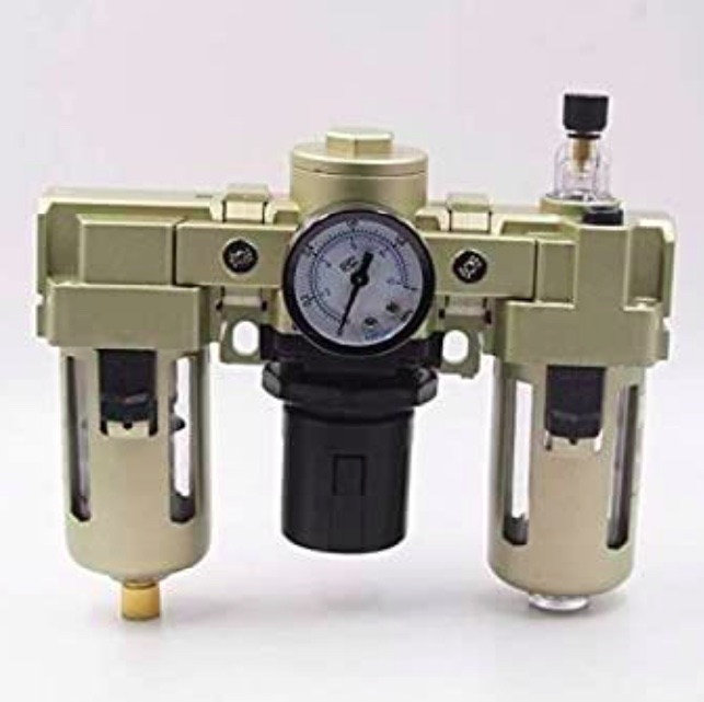

Air preparation is a term that describes the components needed to prevent contamination from solids, water and oil. Plant air from a compressor flows through multiple devices, pipes and fittings that can add particulates, oil and moisture. Even though air dryers, filters, water separators and regulators are often present at the compressor, the air is should also be treated at the machine to prevent damage.
Manual shutoff valves can be used to remove incoming air from the system. They can also be locked for safety purposes.
Filters are used to remove particulates and water from the incoming supply. They have a clear glass or plastic bowl so that the liquid can be seen. Mist Separators are used to remove aerosol state oil mist from the exhaust of process air. They can look similar to the filter shown below, but it may also be large self-contained systems. Regulators reduce and control the incoming pressure for machinery. They use a spring with a diaphragm to allow excess pressure to escape and usually have a gauge attached.
Lubricators were important at one time to lubricate rubber parts like seals inside pneumatic components. Seal materials have evolved over time however and lubricators are usually only required for pneumatic tools and some air motors or air clutches. Most modern machines do not use lubricators. FRLs/FLRs, or filter-regulator-lubricators, are unitary self-contained units that accomplish filtering, pressure regulation and lubrication.
Figure 4: Example of FRL assembly. Courtesy: Automation LLC

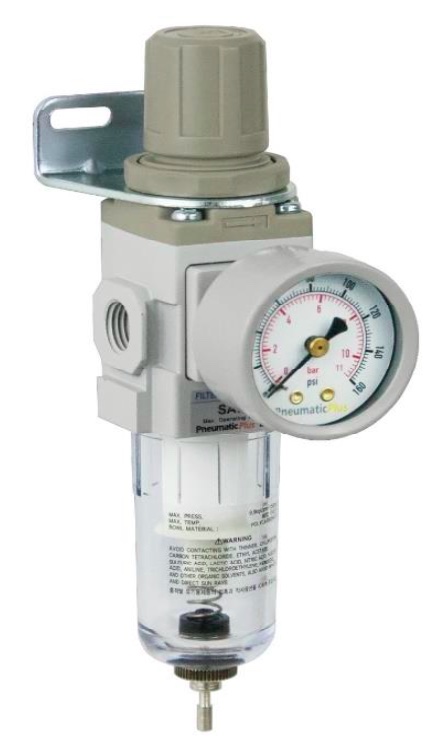

Filter regulators include filtering and pressure regulation without lubrication. They can be combined into a single unit.

Figure 5: Example of a filter regulator. Courtesy: Automation LLC

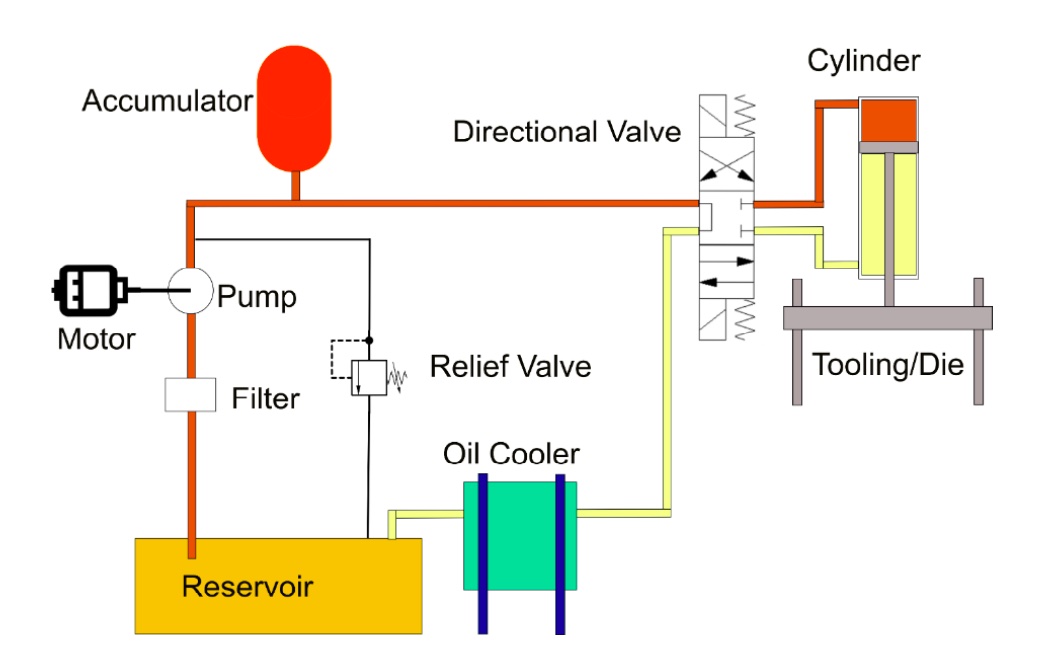

Many of the components of a hydraulic system are similar to those of a pneumatic system, but there are a few differences. A reservoir of hydraulic fluid (oil) is required. Compressed air can be pulled from the atmosphere, whereas fluid has to be supplied.
The filter is made of different materials than typical air filters. They remove both water and solid contaminants from the system. More hydraulic failures are a result of contamination than any other cause.
A pump is required to provide pressure for the system. This is usually driven by an electric motor, but there are other types, even engines are used for some large systems. A relief valve is used to ensure pressure does not exceed the requirement. Fluid is returned to the reservoir.
An accumulator stores energy to maintain pressure, dampen vibrations and pulsing, and improves the efficiency of the system. They are pre-charged with an inert gas, typically nitrogen. A moveable barrier, usually a piston or rubber bladder separates the oil and gas. The gas is usually pressurized to 80-90% of the working pressure of the system.
Directional valves are often used for moving the actuator. These are usually 4/2 or 4/3 configuration. Because of the force required to shift the spool inside the valve body, these may be pilot-actuated, using a pressurized fluid (often about 50 psig) to move the spool.
Proportional valves are sometimes used to control speeds of actuators. These can be controlled from 0-100% by an analog signal from a programmable logic controller (PLC) or another type of controller.
Pressurizing fluids creates heat, which can break down the hydraulic oil and reduce its life. A hydraulic oil cooler is a heat exchanger that removes heat to the outside air. These may be air cooled or water cooled.
Figure 6: Example of a hydraulic system. Courtesy: Automation LLC
