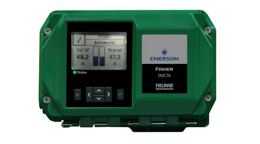

  • The Fisher DVC7K by Emerson employs edge computing for real-time analysis, improving valve performance, reliability and uptime for critical applications.
  • With secure Bluetooth and wired digital network transmission, the controller offers viewing options locally, nearby or remotely, enhancing awareness and enabling quick, informed decisions for valve health.

This digital valve controller is built on 30 years of proven field-tested innovation (Figure 1). Data and information from the controller can be used to improve the performance, reliability, and uptime of both on-off and control valves, and by extension an entire process plant or facility.
The controller interprets data to create an optimized path to action by combining patented technology, experience-based algorithms, and continuous real-time analytics with flexible connectivity and easy integration.
Figure 1: The Fisher FIELDVUE DVC7K is the industry's highest performing and most reliable valve controller, and the first to include embedded prognostics, communicated locally via Advice at the Device.
Figure 1: The Fisher FIELDVUE DVC7K is the industry’s highest performing and most reliable valve controller, and the first to include embedded prognostics, communicated locally via Advice at the Device. Courtesy: Emerson
It uses real-time and onboard edge computing to analyze issues and create actionable information, providing real-time awareness of valve health by analyzing data locally via its on-board diagnostics. If analysis reveals a problem, an alert is created, which can be viewed locally or remotely, providing the information required to create streamlined and efficient work processes. All alerts include recommended actions to fix the problem.
All information can be viewed at the controller’s local user interface, nearby via secure Bluetooth, or remotely after it is transmitted via a wired digital network to a host, such as a distributed control or asset management system. The local user interface provides indication of valve health at a glance via LEDs, and users can drill down from the interface home screen to find more information. Secure Bluetooth enables access to one or more digital valve controllers at distances up to 30 ft from any device capable of supporting Bluetooth, such as a smartphone or tablet. Whether the information is viewed locally, nearby or remotely, plant personnel can use it to drive awareness of valve health.
With more opportunities for remote connectivity and advice at the device, flexibility increases, providing the information needed for fast decisions and quick action to address arising issues. The DVC7K digital valve controller can be specified for all new valve purchases, and it can be retrofitted to most existing valve installations, in either case quickly and easily commissioned via the local user interface.
