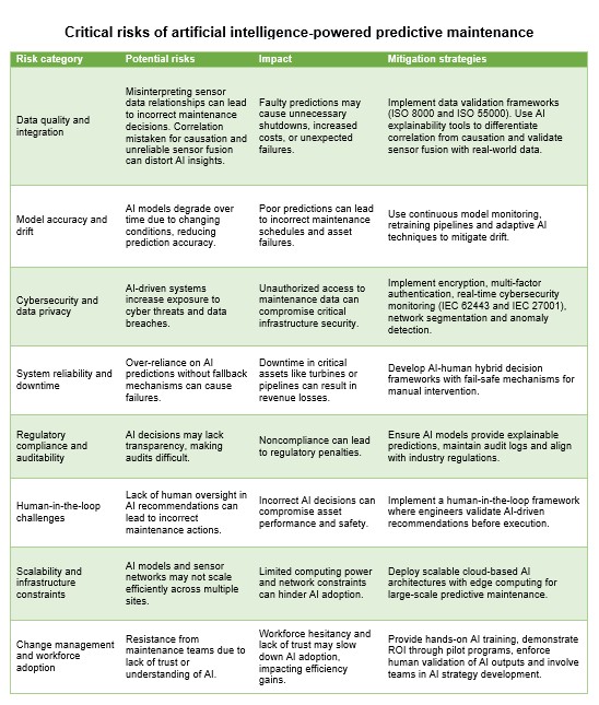

While generative AI enhances predictive maintenance, it introduces challenges that must be addressed for effective deployment. The AIGA Hourglass Model of AI Governance highlights the need for structured oversight, balancing AI automation with human accountability to ensure safe and explainable AI systems.
Data quality and integration remain critical, unclear sensor relationships can lead to incorrect maintenance actions. Implementing ISO 55000-aligned data governance practices, supported by IEC 61987-compliant semantic models and ISO 8000 data quality principles, helps ensure correlation is not mistaken for causation.
Model drift can degrade AI performance over time. Continuous monitoring, retraining pipelines and adaptive AI techniques help maintain accuracy.
Cybersecurity risks increase with AI-driven maintenance, expanding exposure to cyber threats. ISA/IEC 62443 and IEC 27001-compliant security measures, including encryption and real-time anomaly detection, safeguard infrastructure.
To ensure system reliability organizations must not over-rely on AI-driven decisions. Fail-safe mechanisms and human-in-the-loop frameworks should be in place, allowing engineers to validate AI-driven recommendations before execution. Regulatory compliance also requires transparency, where AI models must provide explainable predictions and maintain audit logs for accountability.
By embedding AI governance principles and aligning with industry standards organizations can deploy scalable, secure and reliable generative AI-powered predictive maintenance systems that enhance operational efficiency while maintaining compliance and safety.
