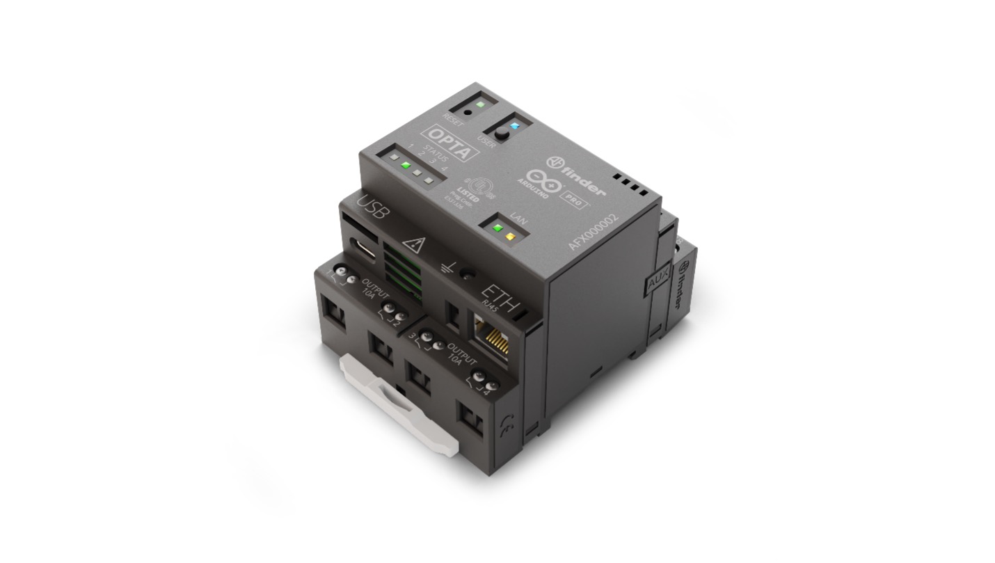

Figure 1: Arduino's OPTA facilitates the retrieval of valuable diagnostics data from older control systems without requiring modification. Courtesy: Arduino
Figure 1: Arduino’s OPTA facilitates the retrieval of valuable diagnostics data from older control systems without requiring modification. Courtesy: Arduino

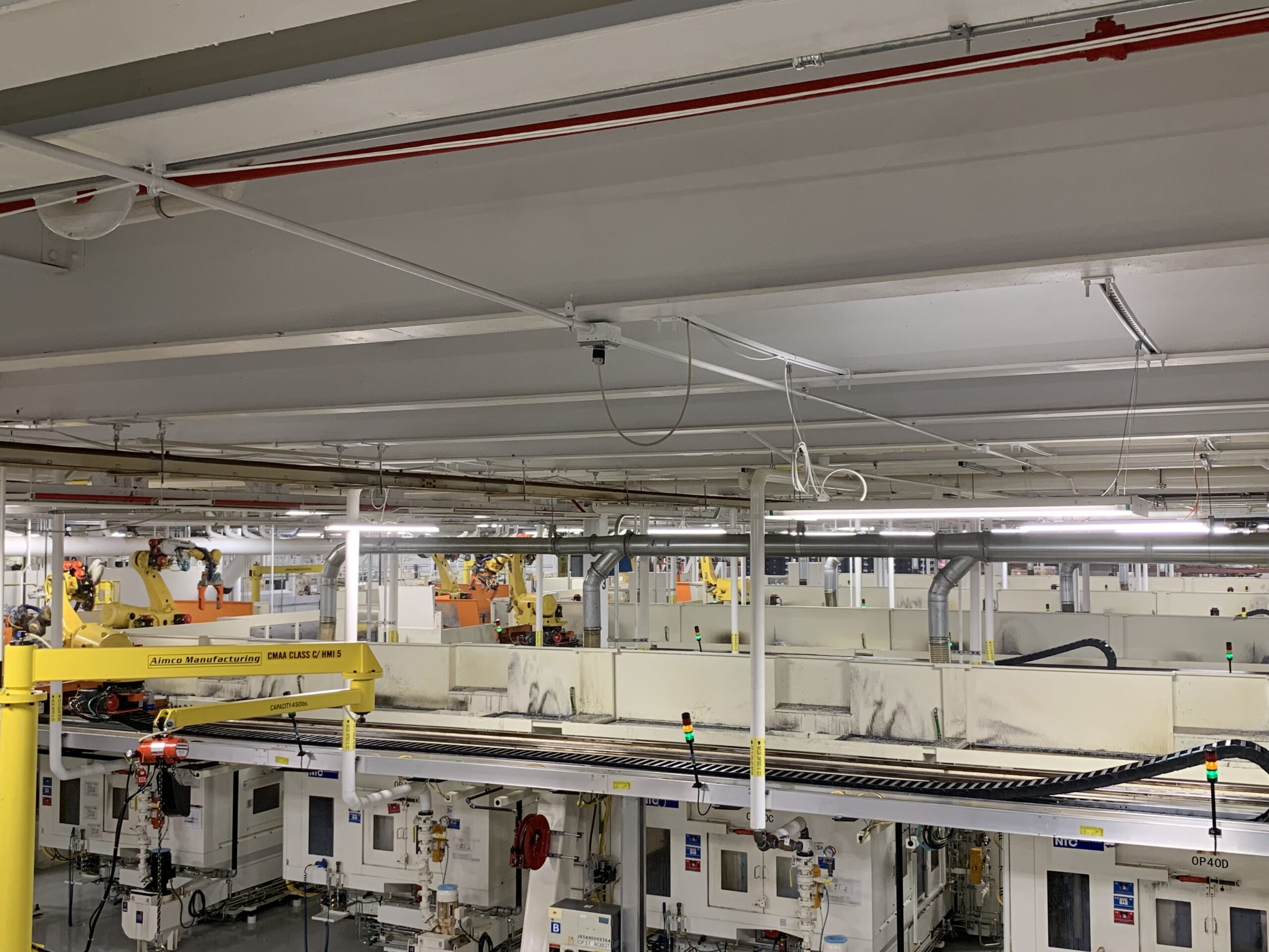

Figure 2: A robot loads five computer numerical control machines. Courtesy: Patti Engineering

To address this common problem, Patti Engineering partnered with Arduino. Arduino’s Opta facilitates the retrieval of valuable diagnostics data from older control systems without requiring their modification. Opta does what a legacy control system can’t do — collect, store, perform edge analysis and integrate data with modern aggregation platforms. It’s a tool that allows manufacturers to obtain better system diagnostics on legacy systems without immediately investing in a full controls upgrade.
