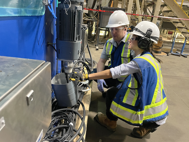

Figure 1: An electrical engineer reviewing a start/stop switch for a variable frequency drive. Courtesy: Hedgehog Technologies
