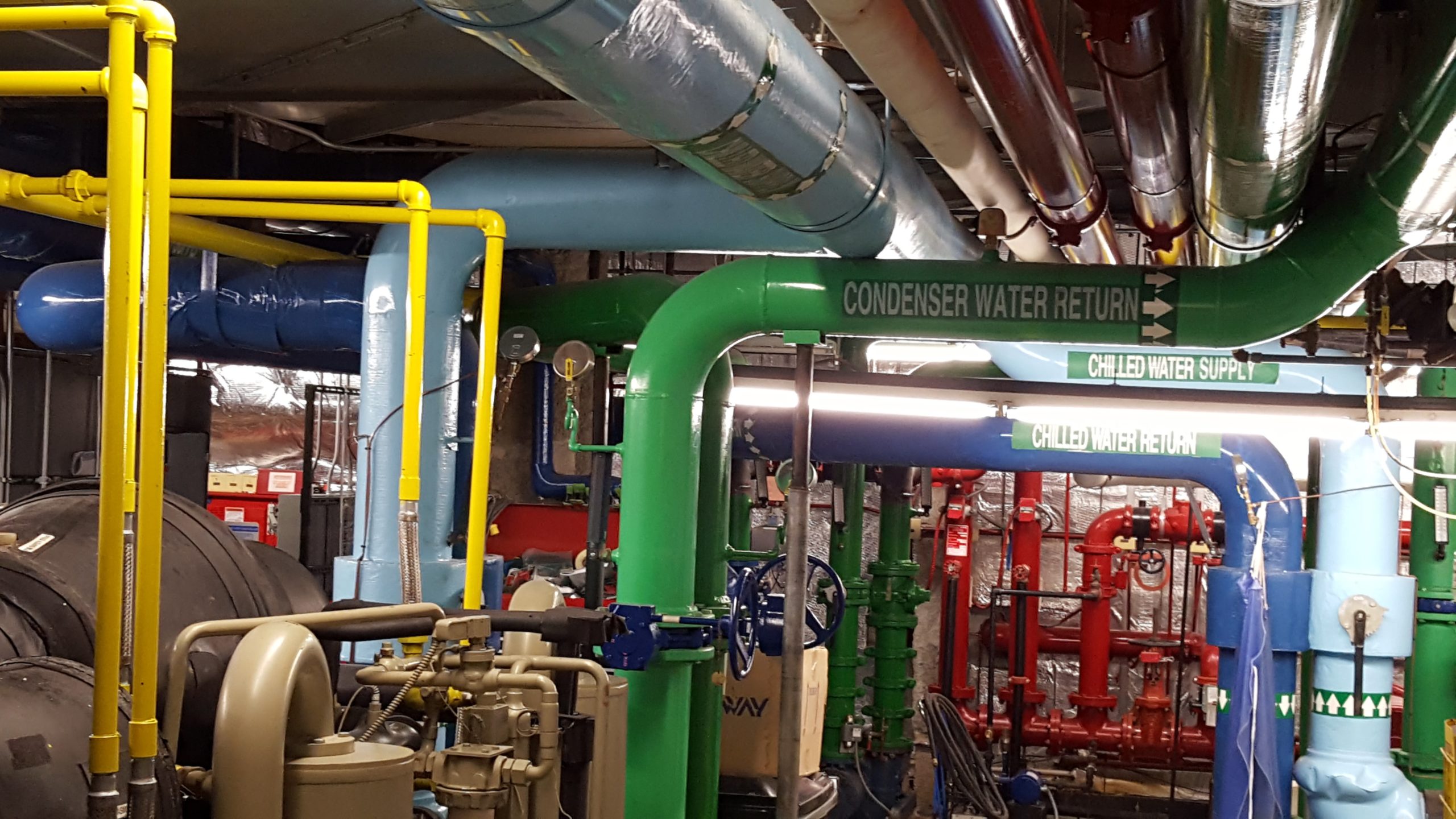

Pipes, valves and pumping systems are common in office building mechanical rooms. Courtesy: CFE Media and Technology

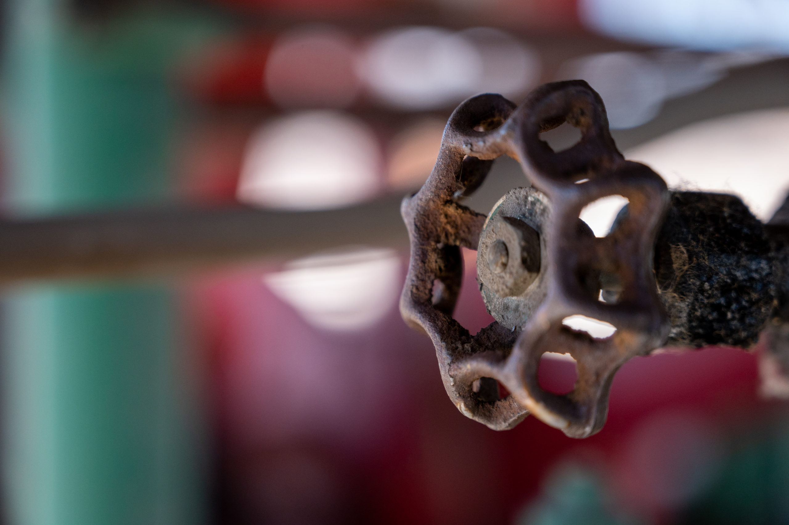

Pipe valve. Courtesy: Brett Sayles
