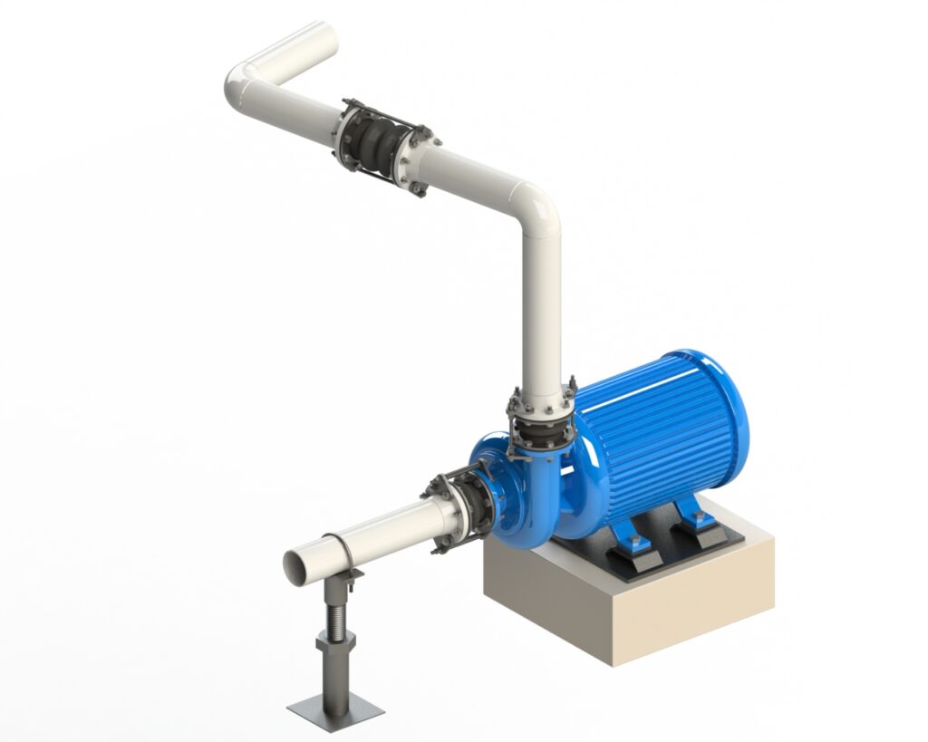

Fiberglass reinforced plastic piping requires its own set of considerations. Courtesy: Proco

Calculating thermal movement: FRP is not steel
The filament-wound structure of FRP pipe creates anisotropic thermal behavior, meaning the material expands at different rates in different directions. In the hoop (circumferential) direction, FRP’s coefficient of thermal expansion approximates that of steel. In the axial direction, it is approximately twice that of steel.
For long pipe runs, which are common in industrial facilities, this axial differential is significant. The expansion joint specification must account for the full thermal excursion: from the installation temperature to the maximum design temperature for expansion from the installation temperature to the minimum design temperature for contraction. Both directions must be within the joint’s rated range of motion, with an appropriate safety margin.
Many projects also require a pipe stress analysis, either through computer modeling or manual calculations, to determine the actual forces and movements at each joint. This analysis drives the allowable spring rate i.e., the force per unit of deflection, the joint is permitted to impose on the system. For FRP, the allowable is typically well below what would be acceptable in steel, making the stress analysis not a formality but a genuine design constraint.
Installation: Alignment, preset support
Even a correctly specified joint can fail if installed improperly. FRP pipe and fittings require careful alignment; industry practice recommends maintaining alignment to within 1/8 inch at the joint. Lateral misalignment beyond that threshold imposes immediate lateral load on the joint and, more importantly, on the FRP flange.
Preset, the practice of partially compressing or extending a joint during installation to center its movement range around the operating condition, is often necessary in FRP systems. Because FRP pipe generates larger axial movements than metal pipe, a joint installed at its neutral position may be unable to accommodate the full operational excursion in one direction. The degree of preset must be calculated based on the installation temperature relative to the expected operating range.
Pipe supports in FRP systems must be designed to prevent lateral movement while allowing axial movement at expansion joint locations. Guides and anchors carry forces that the pipe itself may not be able to bear, making load-path design as important as joint selection.
