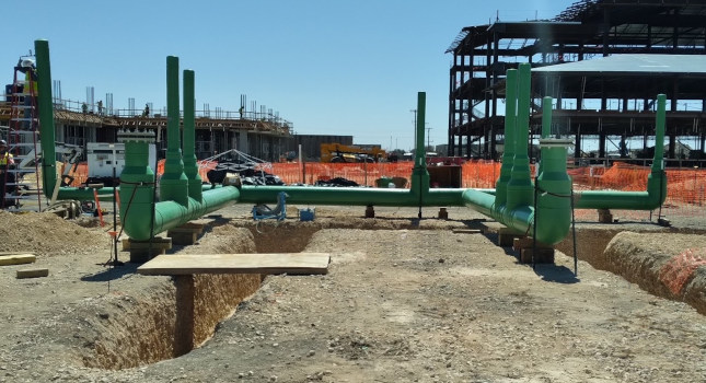

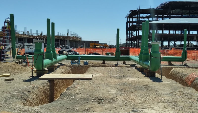

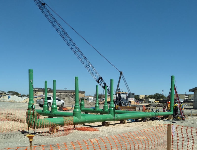

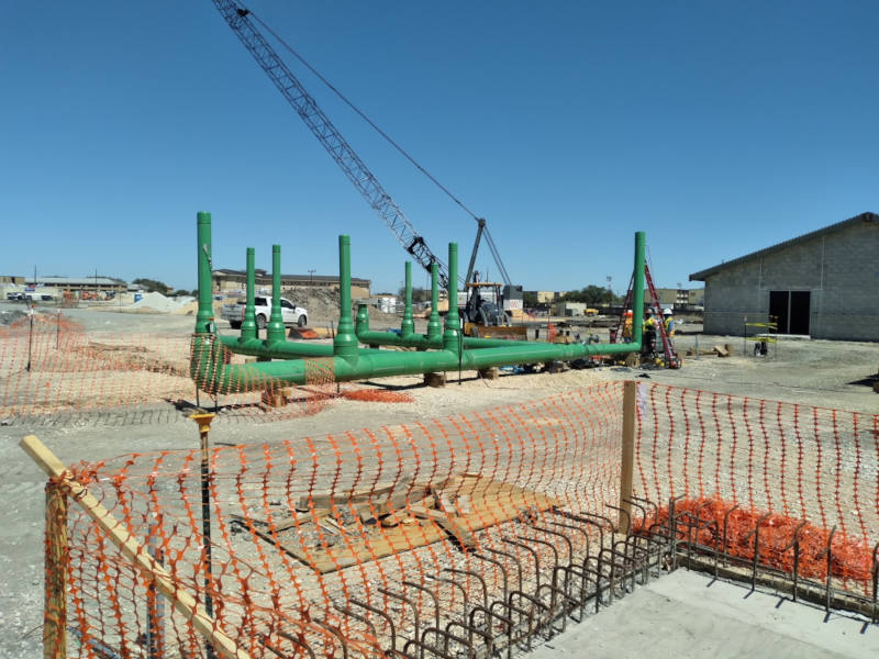

The Air Force’s new basic training facility required large diameter pipe and fittings to move 155ºF (68ºC) water effectively throughout the campus at 90 psi. Using PP-RCT pipe also enabled sections of the system to be fabricated and lifted into the trench. Courtesy: Asahi/America
The design called for pip­ing that would range from four through eighteen inches and consist of both SDR 11 and SDR 17 wall thicknesses, and which would accommodate the different requirements of the cold and hot water services and non-potable lines. Plus, potable pipes need to meet NSF requirements for drink­ing water.
Four to sixteen-inch diam­eter SDR 17 PP-RCT would be used for plumbing, non-potable, while SDR 11 PP-RCT would be used for HVAC chilled and heat­ing water, condenser water, plus domestic hot water in diameters from four inch to eighteen inch.
