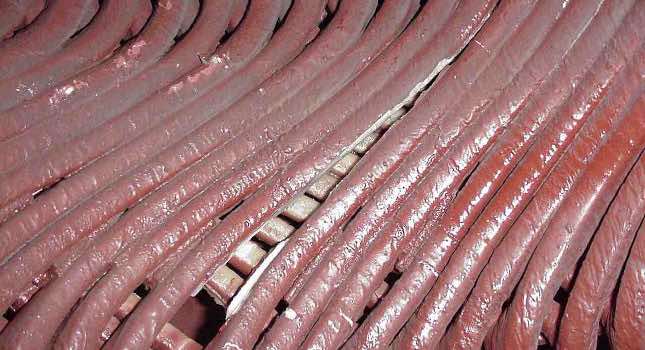

If the motor’s interior is accessible, it may be possible to inspect the windings and other internal components for defects or damage, including the air gap between the rotor and the stator (see Figure 1). A borescope and mirrors on extension rods can probe recessed areas like the rotor’s interior and the space between the stator core and frame to check for debris, contamination, blocked ventilation ducts, cracked welds or a loose fit of the rotor core to the shaft.
Record all damage and defects, remove debris and contamination and perform any maintenance or repairs that need immediate attention. If necessary, schedule nonessential maintenance or repairs for the next regular shutdown.
