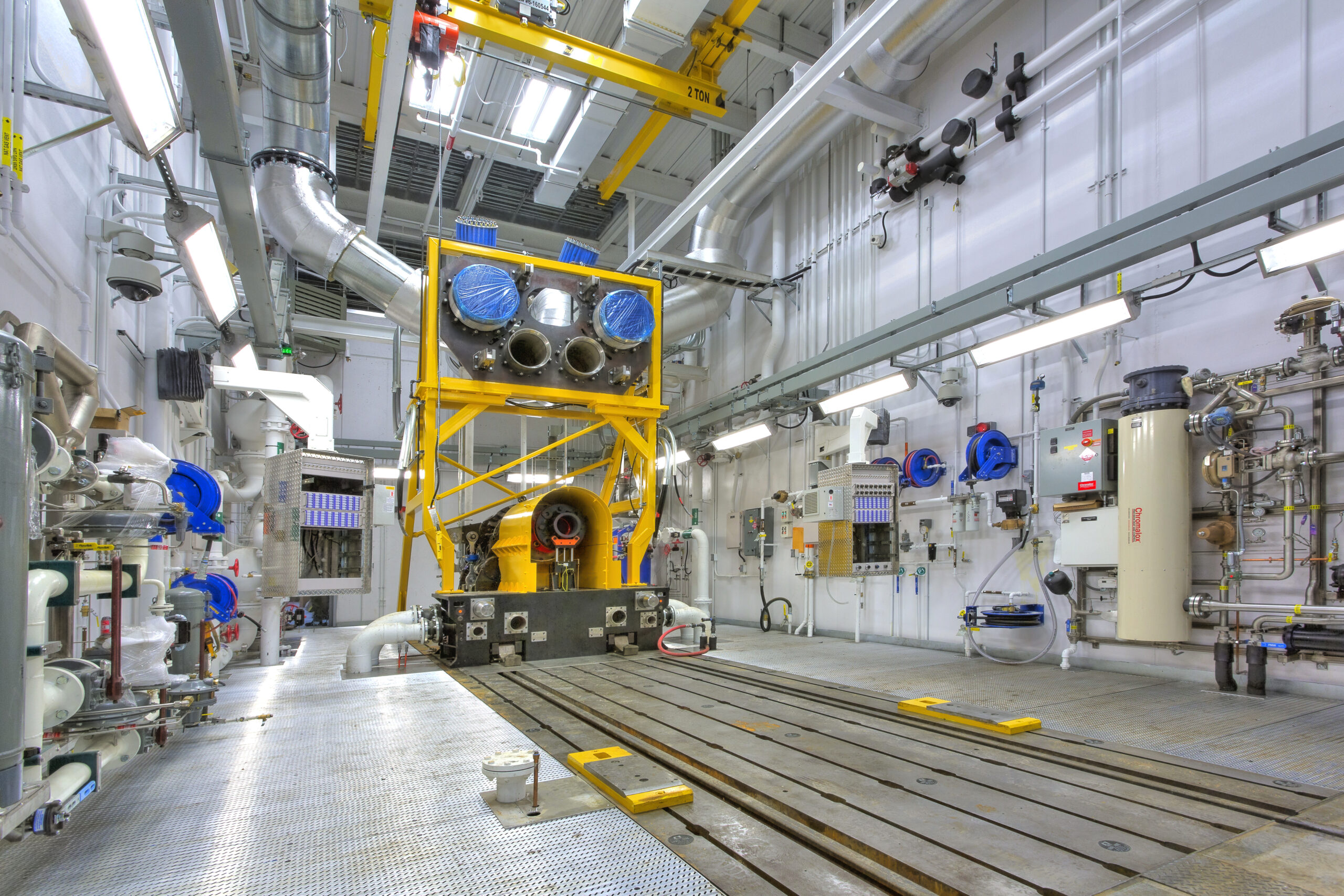

Integration of state-of-the-art software and data acquisition (DAQ) systems enhances cybersecurity and prevents potential attacks. Courtesy: ACS

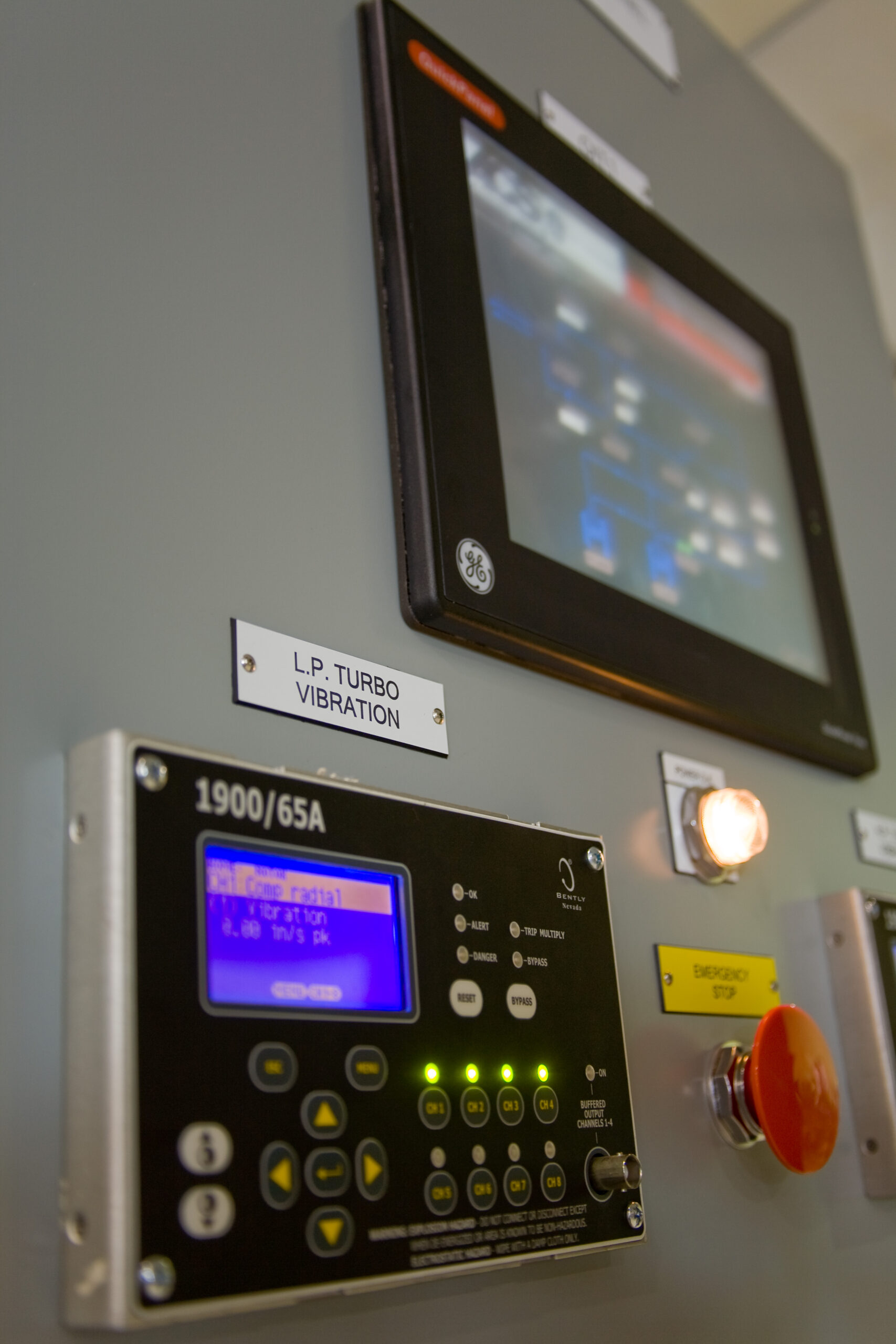

A holistic approach to the integration of equipment, facility, and control systems is foundational to scalability and flexibility. Courtesy: ACS

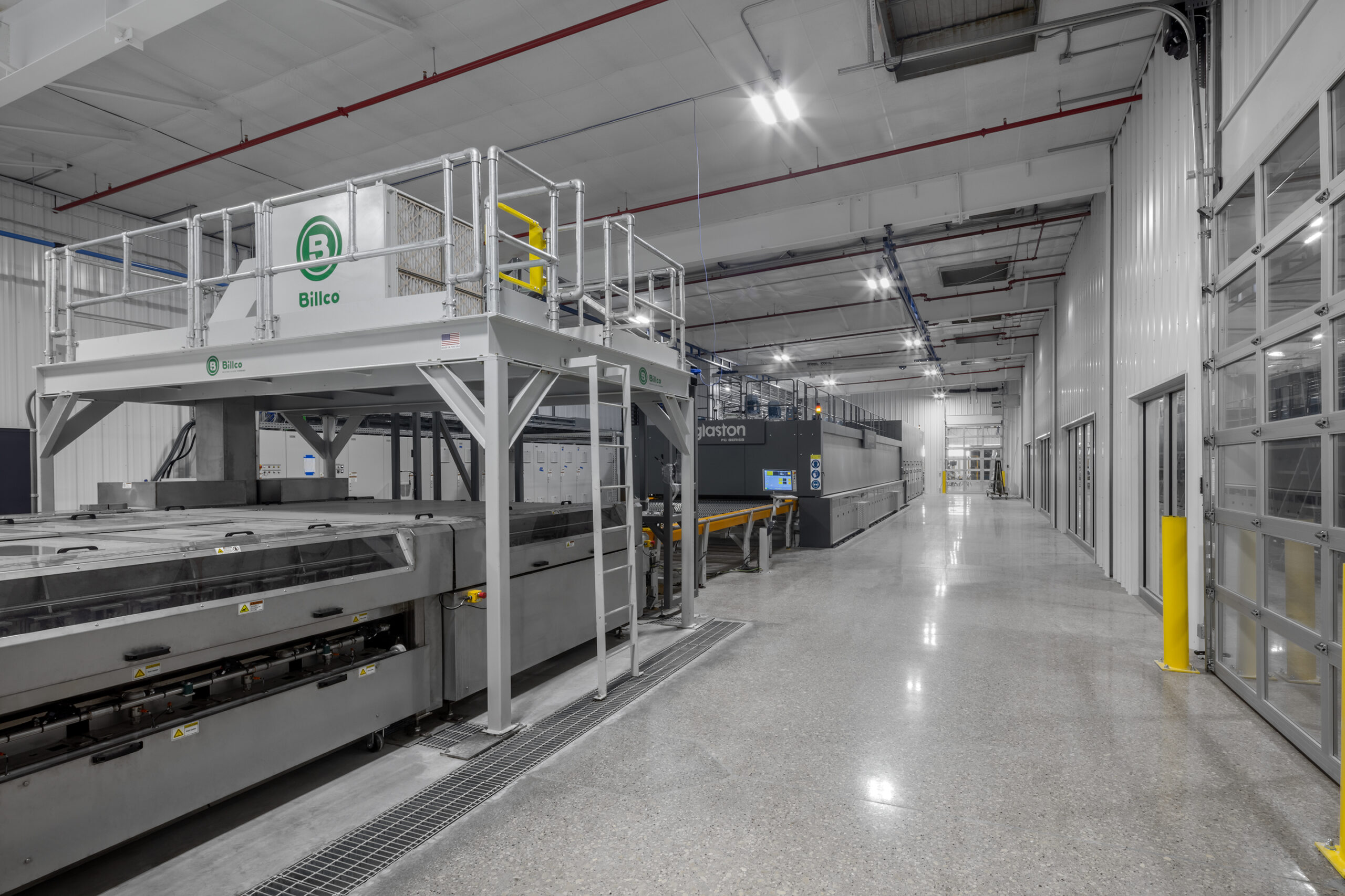

The strategic integration of diverse systems ensures optimal performance and system synchronization. Courtesy: ACS
