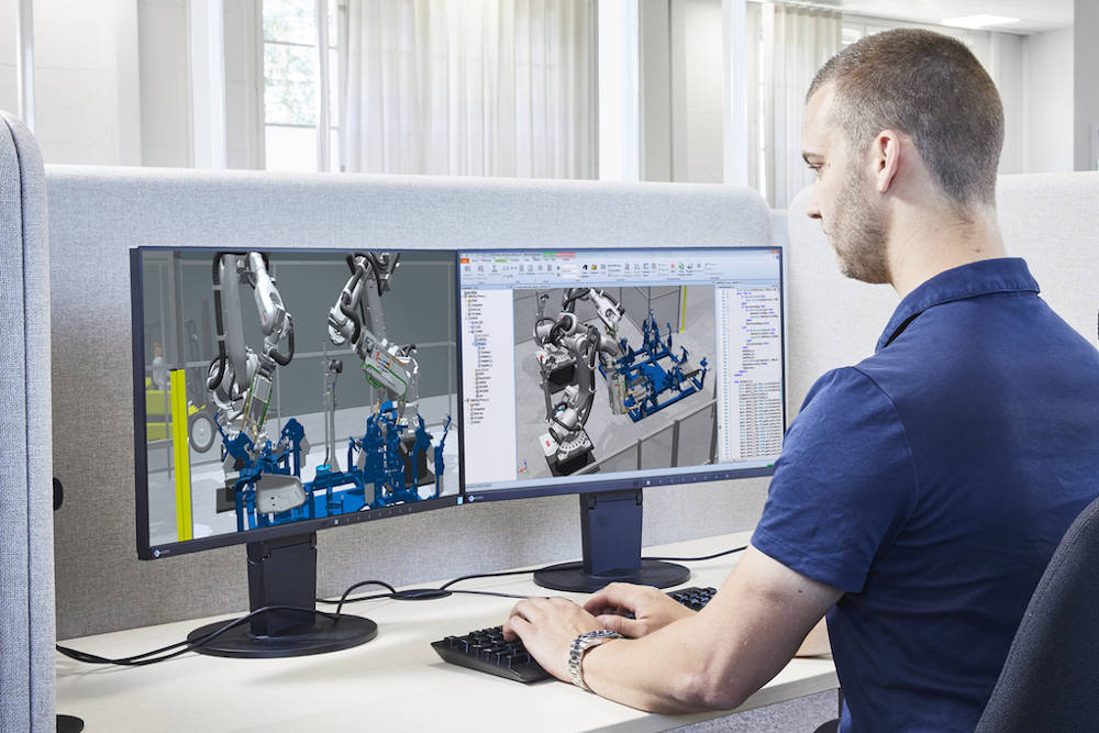

RobotStudio, ABB’s simulation and offline programming software, can be used for virtual commissioning and running a digital twin of the production line in a virtual environment. RobotStudio is useful in all product life cycle stages, helping to introduce and program new products and variants offline without having to interrupt production.
“Every quarter, we are adding new functionality to RobotStudio,” Švub said. “Last year, we improved the ability to do virtual commissioning. We integrated more standard protocols so you’re able to hook up over OPC UA to your equipment, to your PLC, both the physical one and virtual one. You’re able to get the data back to RobotStudio for not only the robots, but also other equipment running through the OPC UA (a cross-platform, open-source standard for data exchange). That means you’re able to simulate, test and validate the complete behavior of the robotic cell or robotic line.
“Especially now, we see more companies pushing us to do virtual commissioning because of the pandemic and problems with travel. This is a great solution to be able to connect remotely rather than move our engineers around the world all the time. We see this trend growing and customers more open to running factory acceptance tests (FATs) even partially in these virtual environments because they start to trust in these technologies.”
Virtual commissioning solution with digital twin technology leverages IIoT connectivity and data analytics to simulate robotic cells in the virtual world to predict and optimize how processes will perform in the real world. Courtesy: A3/ABB Inc.

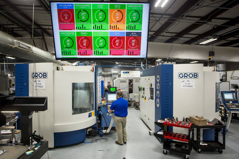

“We’ve made it really easy for manufacturers to capture data from their equipment with an edge device that’s connected to the factory floor network or to the machine itself,” said Bill Bither, CEO and cofounder of Massachusetts-based MachineMetrics. “We’ll connect to sensors, like Balluff sensors, or we’ll pull data right from the machine’s control. Then we’ll automatically transform that into a common data structure, so that all your machines, even though you may have many different types of machines, basically speak the same language. From there, we provide tools to analyze the data, to generate insights from it. For more of the simpler insights, like understanding the capacity of your machines and throughput, that’s all out of the box within the MachineMetrics industrial data platform.
Industrial data platform provides remote visibility into real-time production data to identify bottlenecks, predict machine failures, improve quality and build workflows that automate the operation of machines. Courtesy: A3/MachineMetrics
“But we also allow our customers to enrich the data themselves. That’s where you can be very configurable based on the types of manufacturing that you’re doing. We can provide a whole workflow automation tool that allows you to build out workflows to automate processes around the machine. You can also stream that data into other factory systems, like your production systems and maintenance systems.”
The startup has an entire data science team figuring out how to capture the right data and display actionable insights like cutting tool wear, for example.
“On a metal cutting machine, those tools often wear out. They will start to create scrapped parts, or they’ll break. We’ve been able to enrich that data so our customers can understand when they need to change their tools. Once the data is contextualized, they can use our platform to run custom analytics.”
MachineMetrics cut its chops in the computer numerical control (CNC) sector, but has since expanded to all discrete manufacturing. Industries served include automotive, medical device, heavy industry and aerospace. The industrial data platform is available as software-as-a-service (SaaS) for an annual subscription. That includes all support, access to the customer success team and software upgrades. The power of IIoT means anywhere, anytime access.
“It’s cloud-based, so you can access that data anywhere, as long as you’re authenticated,” Bither said. “The high-frequency calculations are done on the edge, but then that data is sent to a cloud platform where you can bring in context from other places.
“You can run reports to look at what happened over the past three years. That processing is stored in the cloud. It’s built on AWS (Amazon Web Services). Only our customers have access to that data, in a secure way, and they also control what data is sent to the cloud.”
Bither says it’s plug and play: “We have out-of-the-box applications that help our customers drive value immediately. For example, as soon as they connect their machine, they can configure a workflow that will send a notification if that machine is down for more than a certain amount of time or experiences a certain alarm condition. All that is self-service.”
Where it really gets interesting is in the advanced analytics. Remember all those data scientists?
“Advanced algorithms allow us to go a little deeper than what you can see, like trying to emulate the experienced operator who can hear when something is going wrong with a machine. You can emulate that in an algorithm, which is essentially AI, and then deploy that at scale. That’s what we’re doing by making the data accessible and then providing the tools to emulate the human in those cases,” Bither said.
IIoT and AI-powered data collection solution delivers insights anywhere and anytime, including utilization reporting, condition monitoring, real-time production dashboards and downtime alerts. Courtesy: A3/MachineMetrics
The company conducted its own benchmarking study in 2020, with opt-in by MachineMetrics customers to aggregate the utilization data for all the machines they have connected. The results showed a surprising average machine utilization rate of only 24%. Bither says this was much lower than what customers expected.
“Without visibility, you’re unable to make positive change. With MachineMetrics, we provide real-time visibility into everything that’s happening with your equipment. With that, you can continue to improve your processes and eventually move to more automation. That’s really our mission. What we’re building is that operating system for the autonomous factory.”
