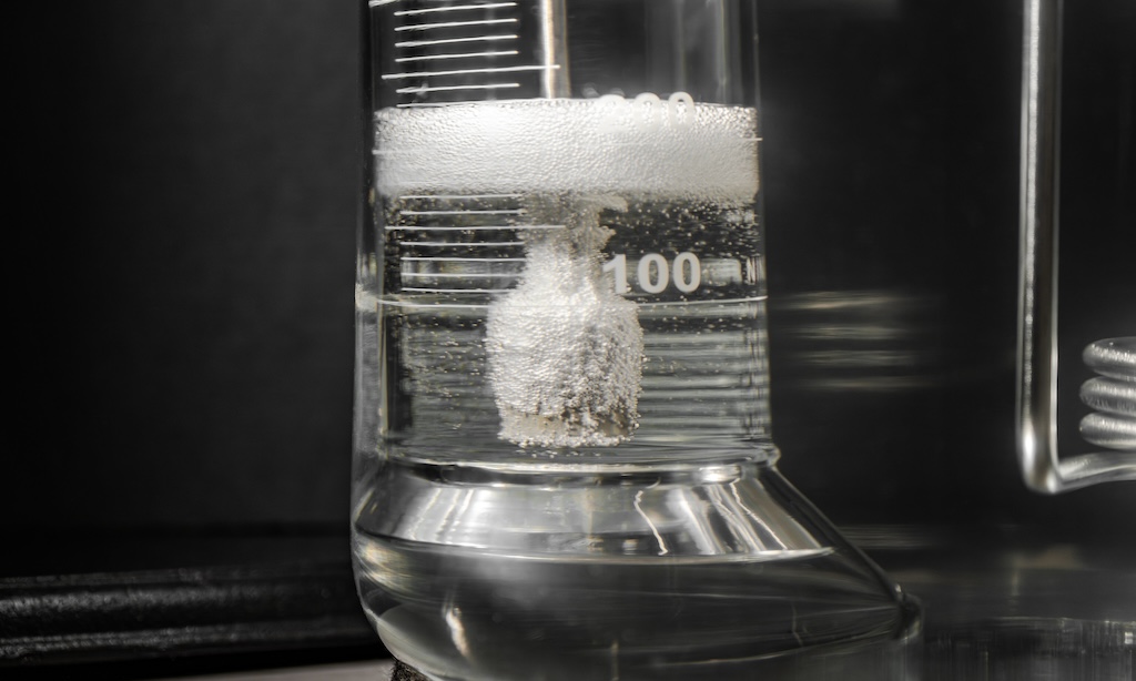

Reducing or eliminating foam is also critical for several reasons. Foam and the air it contains will interrupt fluid film formation and inconsistent fluid film will lead to several operating issues, including increased metal-on-metal contact and corrosion. Foaming is typically a symptom of rogue air ingested into the system through line leaks, low fluid levels or breather or filler cap deficiencies.
Foam can also be generated when incompatible fluids are mixed resulting in a chemical reaction. This is often one of the earliest tip-offs that incompatible fluids have been inadvertently mixed in service.

Figure 2: Foam at the top of an oil sample. Courtesy: JAX Inc.

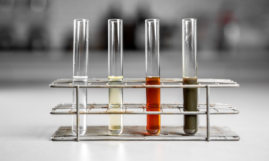

Figure 4: Progression of in-service oxidation (test tubes). Courtesy: JAX Inc.

How to identify fluid oxidation
The first and easiest identifier of excessive fluid oxidation are our eyes and noses. Oxidized fluids will darken and often exhibit a burnt or “off” smell compared to new fluid. Used oil testing to determine acid numbers and oxidation levels through titration and Fourier transform infrared analysis will quantifiably determine the level of degradation to the fluid. When approaching condemnation limits, there will be additional issues such as increasing viscosity and a tendency to form deposits and varnish on components.

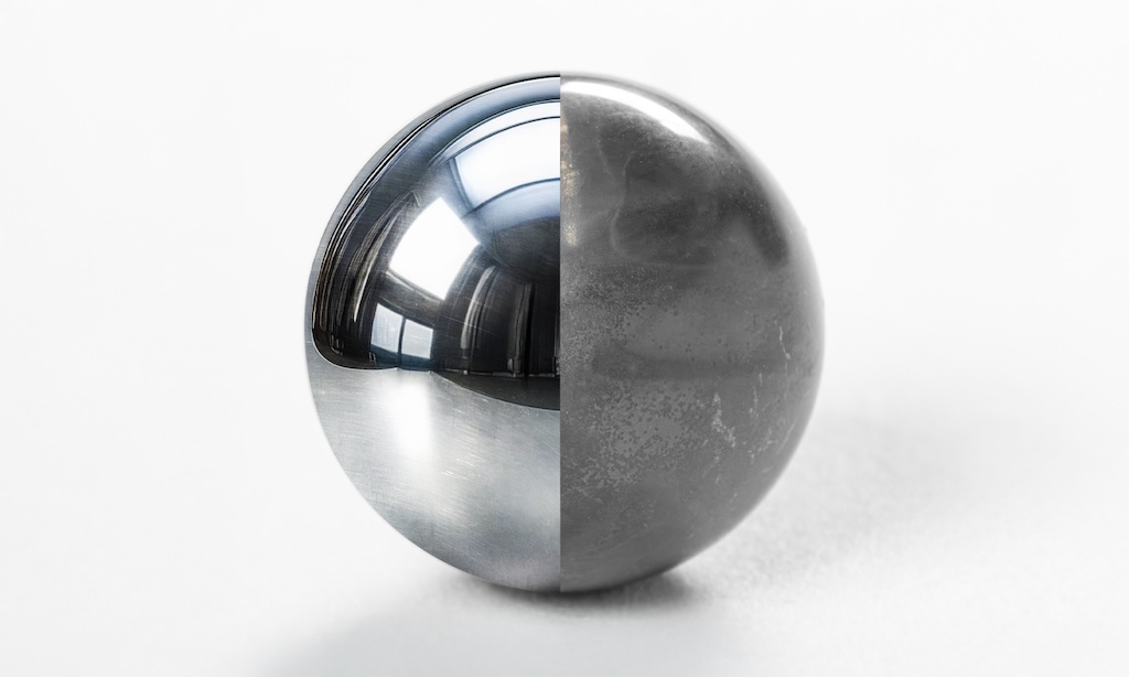

Figure 5: Surface appearance: new versus pitted. Courtesy: JAX Inc.

Cavitation and pitting wear are also serious problems. When small, entrained air bubbles collapse, a hot jet stream is created where air rapidly passes through the center. If this occurs in areas close to component surfaces, the localized shock waves and microjet streams will generate noise and cause micro pitting, which is surface damage on the interior of a machine.
Pitting can affect gear teeth, centrifugal pumps, hydraulic components and other parts that eventually leads to degradation of the asset. Individual pits can often be observed in softer materials after even a single bubble collapse.
Over time, the pitting caused by the collapse of these micro bubbles produces severe wear on components. This will manifest visually as a dull looking surface like fatigue failure. Light bounces off the metal randomly without reflecting directly back anymore; it is scattered. High volume flow rates will increase the intensity of pitting damage. If not remediated, this cavitation fatigue damage can become significant enough to crack metal deep through the surface until the part or surface no longer functions.
