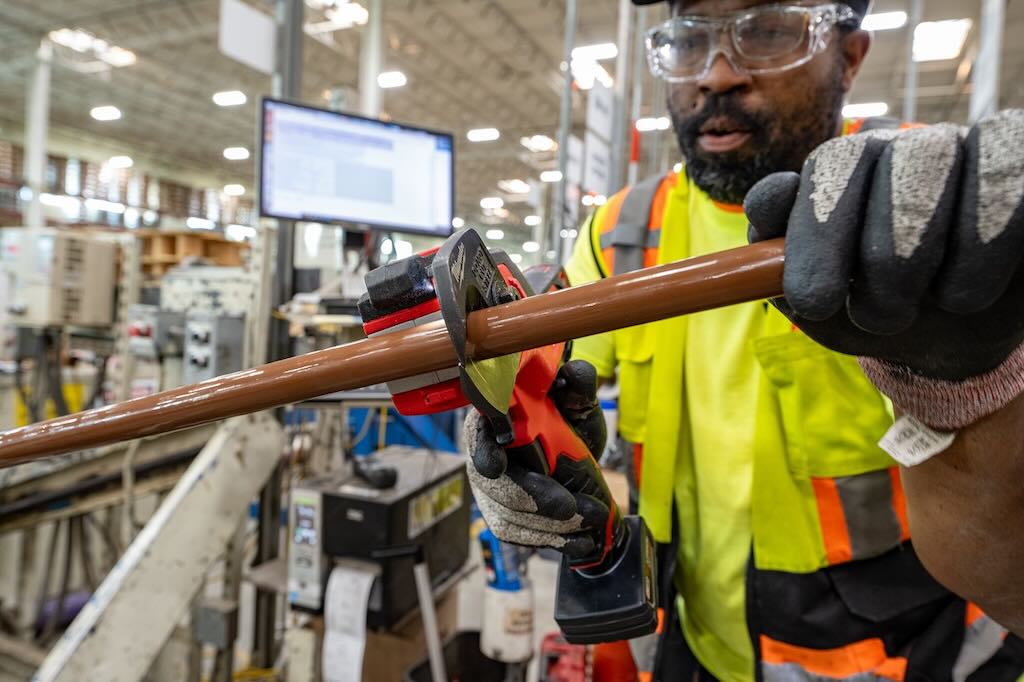

Myth No. 4: One glove is as good as another.
Gloves are designed for specific hazards. A cut-resistant leather glove, for example, will do little to protect employees from impact hazards. Before purchasing gloves for your facility, identify the types and severity of hazards. Then, select gloves that appropriately protect personnel from those hazards (see Table 2).
