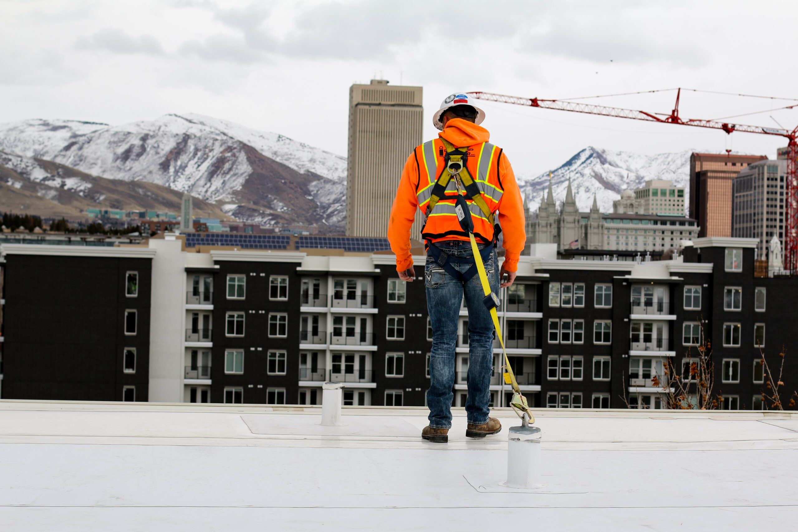

Figure 1: Rooftop worker with personal fall protection system. Courtesy: Diversified Fall Protection

Ensuring a perfect fit for fall protection
Many harness manufacturers advertise body harnesses with a universal size, but each person must ensure their harness is properly adjusted to their body. Every OSHA and American National Standards Institute (ANSI)-approved fall protection harness will have five points of adjustment — two leg straps, two shoulder/torso straps and one chest strap.
The leg straps should be adjusted tightly enough to remain stationary on the user’s leg but not so tight as to cut off circulation. One common rule to determine leg strap tightness is called “flat hand, not fat hand.” This is where a user’s extended palm (flat hand) but not their fist (fat hand) can comfortably slip under the leg strap when tightened.
The shoulder and chest straps should then be fitted in unison. Users should ensure their shoulder straps fit snugly by pulling on the tensioners located near their torso. The user should feel slight tension on their shoulders from these straps and they shouldn’t be able to slip off while moving around. If the shoulder straps are properly tensioned, they should help the chest strap sit in its proper place, which is aligned with the creases created by a user’s armpit when they hold their arms flat against the side of their body.
It is important to have the chest strap set at the proper height. If it’s too high, the user risks being choked by the chest strap, as it may elevate when the user is suspended during their fall arrest. A strap that’s too low could cause the worker to not remain upright during fall arrest. If a user is not properly positioned upright during fall arrest, the user’s spine may incur more force and resulting in a greater risk of severe injury. Most chest straps are adjustable and should be tensioned to sit flat against the user’s chest.
Proper tension is crucial to ensuring a worker remains safe during fall arrest. A properly tensioned harness encourages the user to maintain a proper, upright posture. It keeps the body stationary during fall arrest, which best mitigates the fall forces that the harness can partially absorb during fall arrest. If a harness fits loosely, the harness will suddenly become very tight in crucial areas, like the groin or pelvic region. This sudden tightening of the harness can cause unanticipated injury and will not properly absorb forces from the user.
Fall protection manufacturers must ensure no more than 1,800 pounds of force are felt by a user in their harness. However, this can only be performed if the user wears the harness correctly, according to the manufacturer’s instructions.
