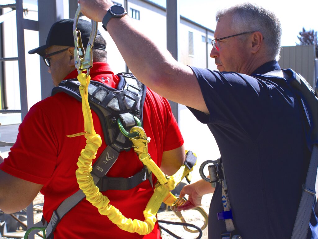

OSHA requires employers to designate and train workers before they can use fall protection equipment. After initial fall protection training, companies must document the authorized users and the training must be performed by the competent person or an American National Standards Institute (ANSI)-accredited training organization. Industry consensus suggests that fall protection training should occur annually, but more frequent training will help keep fall protection awareness top of mind.
Figure 2: An employee receiving a hands-on demonstration during a fall protection training. Courtesy: Diversified Fall Protection
