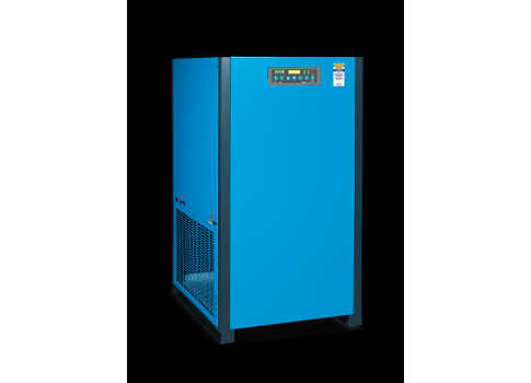

Someone who purchases a dryer from a company participating in the CAGI performance verification program can be assured that the performance of the purchased unit will match expectations. But what about dryers that are produced by manufacturers that do not participate in the CAGI performance verification program? CAGI tested a unit that did not participate in the performance verification program.
The unit was purchased directly by Intertek, the same third party test lab that CAGI uses to administer its performance verification program, and the unit was shipped directly to the test lab. Intertek obtained performance claims from product brochures on the manufacturer’s Website and tested the unit to the ISO 7183 standard, using the same requirements that apply to units tested in the CAGI program. Below are the official test results generated by the lab:
*Specific power input at full flow, kW/100 cfm
**Considering allowable tolerance in standard, result if manufacturer was a participant in the CAGI performance verification program.
End users that purchase this dryer model based on the claims of the manufacturer would have far more water in their system than what the manufacturer claimed. The difference in dew point is significant and could result in potential damage to the end user’s equipment and facilities; i.e. pneumatic tools, piping, etc., and have a negative impact on products or manufacturing quality. The increased pressure drop through the dryer would reduce system pressure, leading users to increase compressor operating pressure to compensate, thereby increasing power consumption of the air compressor.
The performance of this 200 cfm dryer is disappointing when compared to the manufacturer’s claimed performance, but imagine extrapolation of these deficiencies to larger dryers. For example, assuming similar failures in a 1000 cfm dryer, an additional 5.3 gallons of water would be introduced into the compressed air system per day. Economic losses due to additional pressure drop (above claimed performance) alone would be approximately $1,300 per year at $.07/kWh. A distributor who sold this dryer to customers would have a lot of explaining to do, as poor product, damaged production equipment and facilities, excess corrosion, and decreased profitability most likely would damage the distributor/customer relationship. Continued reliance on such dryers could lead to a distributor’s reputation and expertise being questioned in the market.
