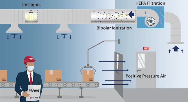

1. A safer work environment
Keeping air moving at a faster pace in areas where workers are present can help reduce the risk of person-to-person COVID-19 transmission through aerial droplets, which is believed to be the main mechanism through which the virus has spread. This can be accomplished by creating a positive pressure environment, where the air pressure is higher inside an area than surrounding rooms. The higher relative pressure forces the air to constantly vent outside the working area as it’s refreshed with clean air.
2. Elimination of airborne contaminants
HEPA filtration can remove airborne particles like dust, dirt and flying insects from being introduced to your plant through the ventilation system. On top of that, the entire spectrum of ultraviolet (UV) light has been shown to kill bacteria and viruses, with UV-C light being the most effective. However, UV-C light sources must be concealed because direct exposure to people can be harmful. In meat-processing facilities, dangerous food-borne pathogens like salmonella and listeria must be mitigated for consumer and worker safety. The direction and frequency of air flow in these facilities is paramount to removing these dangerous pathogens. Air from areas where raw meat and poultry are handled should never flow to areas where the finished product could be exposed to airborne contaminants.
