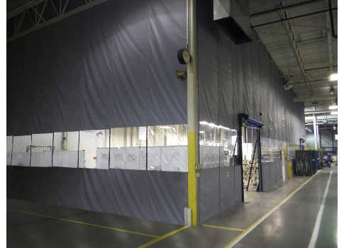

The value of fabric curtain walls
Fabric curtain walls also allow separation between processing areas and clean rooms or finishing areas. Curtain walls also can be reconfigured if the facility layout changes.
In a situation where a positive pressure space is desired, some sort of enclosure (or "box") around the space would be optimal to maintain the pressure differential. Fabric curtain walls are less expensive to install than hard walls and create a comparable enclosure seal to a hard wall.
The inclusion of standalone, high-speed roll-up doors in the curtain wall allows for efficient thoroughfare while minimizing time the interior is open to the processing area. In the same way as a permanent wall, fabric curtain walls act as a physical barrier, blocking particle transfer. Because they are made of flexible fabric, they also are relatively easy to reconfigure if a space needs to be enlarged, reduced, or the shape of the space footprint needs to change. Fabric curtain walls can be trimmed to fit around conduit, piping, ductwork, or other permanent infrastructure and can be anchored to the floor to withstand pressure differential across them.
