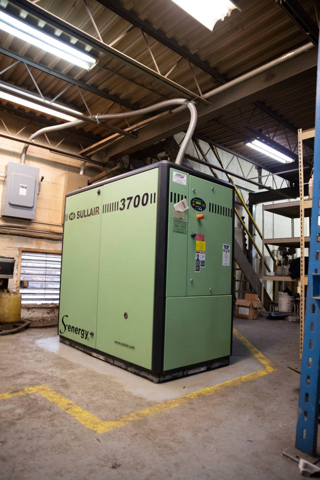

When it comes to rotary screw air compressors, it is important to follow the prescribed service and maintenance program.
When it comes to rotary screw air compressors, it is important to follow the prescribed service and maintenance program. A maintenance program is one of the most critical components of system management, since so many machines and functions within industrial facilities rely on compressed air. This helps ensure a smooth-running operation and helps prevent interruptions and unexpected downtime.
First and foremost, it is important to follow the maintenance plan and service intervals to maintain your warranty. This includes things like routine oil sampling, motor greasing and fluid changes. If you do not comply with the items needed to maintain the warranty, any future warranty claims will often be denied.
Additional, regular service items depend on the application in which your air compressors are used. For instance, if your compressor is used in a clean application, like pharmaceutical, it will require less maintenance than when used in a dirty or dusty environment, such as sawmill in the middle of the woods.
There are also a few components of rotary screw air compressors that may not necessarily be a part of service intervals, but you should keep a close eye on and maintain.

Cleaning the coolers
While there is not a defined service interval for cleaning the coolers, if they are overlooked can cause the compressor to overheat and become unreliable. Bugs in particular can be problematic as many are acidic, which can damage the exterior surface of the cooler. Thus, clean the coolers as often as needed. As mentioned, a compressor in a pharmaceutical application will not require this as often as a compressor in a sawmill.
