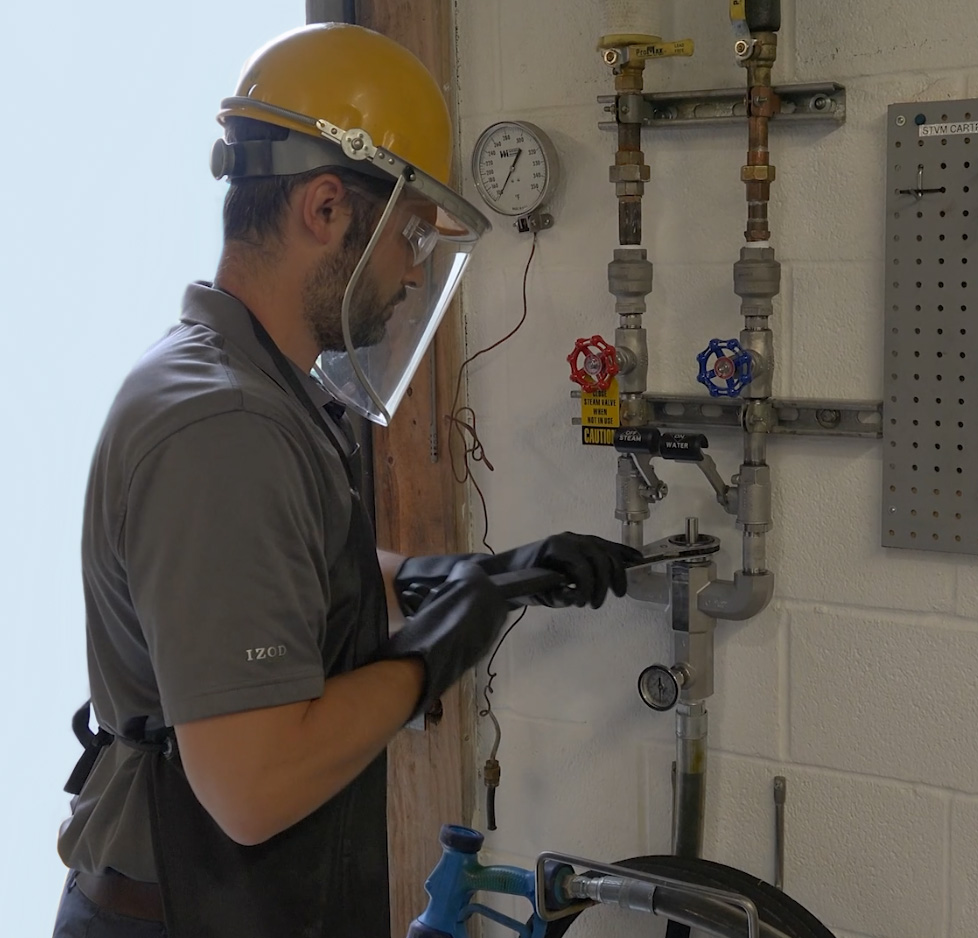

All-inclusive training programs should educate employees on proper hygiene practices, personal protective equipment (PPE) use and equipment handling.
All-inclusive training programs should educate employees on proper hygiene practices, personal protective equipment (PPE) use and equipment handling. Courtesy: ThermOmegaTech
