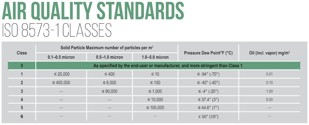

Air quality is broken down into seven primary classes of three contaminant types: solids, humidity and liquid water and oil. Solid particulates (like dust or pipe scale) can be removed by filters. Humidity and liquid water can be removed by compressed air dryers. Oil (liquid and vapor) can be removed by coalescing oil removal filters and activated carbon (charcoal) oil vapor adsorbing filters.
The International Organization for Standardization (ISO) 8573-1:2010 Air Quality Classes outlines the contaminants allowed by class. Depending on the application, Class 1 air – sometimes called “technically oil-free” may be appropriate, but also may require additional downstream filtration.
For applications where air purity is essential, Class 0 air has the most stringent requirements for each type of contaminant – solid particles; water/moisture; and oil and oil vapor.
Figure 1: ISO Air Quality Standards define oil vapor and solid contaminant class levels in compressed air. Courtesy: Hitachi Global Air Power
ISO8573-1:2010 measures contaminants in three categories:
  • Solid particles: Measures the solid particles contained in the compressed air stream. Within this column are three sub-columns indicating the quantity of allowable particles by micron size. The bigger the particle, the fewer parts per million allowed.
  • Pressure dew point: Measures the maximum allowable water content in the compressed air stream.
  • Oil (including vapor): Measures the maximum allowable oil content in the compressed air stream.
Class 0 air is more stringent than Class 1 and essentially, the lower the class, the lower the concentration of compressed air contaminants. For applications requiring oil-free air, Class 0 air is a less risky solution than Class 1 because it doesn’t require inline filtration — which may fail and requires regular monitoring — to remove oil contamination which may be coming from the compressor.

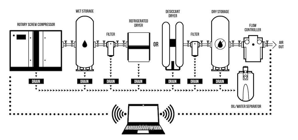

Figure 2: Inlet air filters help to reduce contamination from ambient air as it enters the compressed air system. Courtesy: Hitachi Global Air Power
Recognize just because an oil-free compressor doesn’t introduce lubricant into the compressor chamber doesn’t mean oil can’t be introduced from the outside air. If the ambient air feeding the compressor contains oil vapor from other machinery, etc., the air leaving the compressor may be contaminated. Think, garbage in, garbage out. To help maintain air purity when using an oil-free compressor, particular attention should be paid to the intake air. The cleaner the intake air, the less chance of contaminants downstream which can affect production. To meet even more stringent air quality needs, air treatment (filtration; mist elimination) may still be necessary to eliminate other contaminants.

Once the compressed air leaves the compressor, there are more opportunities for it to be treated before leaving the compressed air system and entering the greater manufacturing process. The major categories of air treatment in a compressed air system are 1) dryers – most commonly refrigerated and desiccant – more on those below – and 2) downstream filtration and mist eliminators. There are dozens of different options and assortments to help remove contaminants from compressed air.
Figure 3: Removing excess moisture from compressed air with a refrigerated or desiccant dryer helps maintain air quality and is an important step in preventing rust and corrosion in your compressed air system. Courtesy: Hitachi Global Air Power
For an industrial compressed air system, removal of moisture from the compressed air stream is a vital task. Dry compressed air* helps keep air-powered tools, equipment, and instruments running well. It can also help prolong the life of both tools and piping by reducing the rate of corrosion caused by excess moisture. In sensitive applications, where the air contacts the final product, or in some cases even its packaging, it is critical the compressed air be the proper quality, including the dew point of the air.
Refrigerated air dryers as their name implies, remove moisture from the compressed air stream mechanically by cooling it. Cool air can’t hold as much water vapor as warm air, so as the air cools excess water vapor condenses out as liquid water which is then removed from the system.
Desiccant dryers remove moisture from the compressed air stream chemically by passing the air over a bed of desiccant. The desiccant adsorbs the water vapor, meaning the water vapor clings to thousands of tiny pores in each bead of the desiccant. Once the desiccant bed becomes saturated, either very low dew point compressed air or heated purge air is used to dry the desiccant. Desiccant dryers often have drying beds arranged in pairs. So while one desiccant bed is drying the air, the other desiccant bed is being dried, allowing for continuous drying of the compressed air stream.
