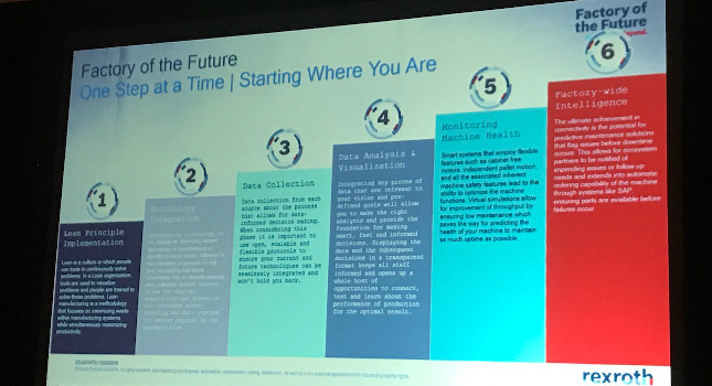

Step 1: Lean principle implementation. Lean is a culture in which people who look to continuously solve problems, Rusk said. In a Lean organization, tools are used to visualize problems and people are trained to solve them.
Step 2: Technology integration. It can be as simple as deploying sensor technology to troubleshoot or identify problem areas.
Step 3: Data collection. When reaching this step, companies need to be careful about why they’re collecting data. Collecting data just because has no value to a company. There needs to be a purpose.
Step 4: Data analysis and visualization. How is the data being visualized and used? What’s happening to the data? Rusk said it’s all about getting the right data to the right people, which leads to better and quicker decisions.
Step 5: Monitoring machine health. When people think of Industry 4.0, Rusk said, they’re usually think of this step, which involves machine learning. Most manufacturers, he said, are not at this level and there’s not much of it in the companies that are using.
Step 6: Factory-wide intelligence. “This is where artificial intelligence (AI) comes into play,” Rusk said. “We already see it on some level with smart cars, smartphones, and other technologies.” This step, he said, is about the potential for predicting when something is going to fail before downtime occurs.
“The whole key of the six levels is we’re all starting somewhere,” Rusk said. “Figure out which level you’re at and start there. We tend to try and go for the end goal, but that causes a lot of confusion and ultimately wastes money. We like to think we’re ready, but often, we’re not.”
