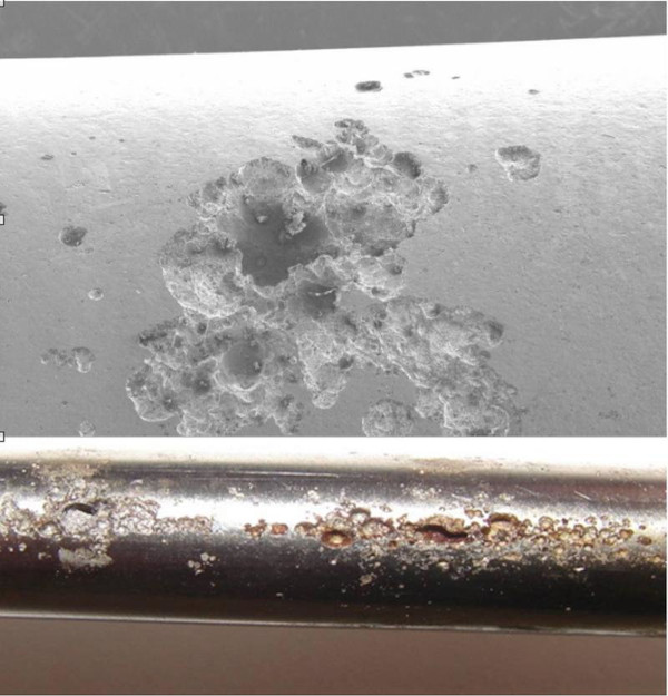

Figure 2: Pitting corrosion can easily form on 316/316L stainless steel tubing contaminated by acids, salt water and other deposits.
Figure 2: Pitting corrosion can easily form on 316/316L stainless steel tubing contaminated by acids, salt water and other deposits. Courtesy: Swagelok Co.
Keeping each of these contact points operating at peak performance is no small feat and it starts with choosing the right components for the job. That means selecting fittings and fixtures that resist pitting (see Figure 2) and crevice corrosion (see Figure 3), both of which are common in offshore oil and gas applications.
