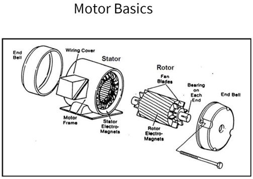

For motor basics, there are two main things to focus on, which are the stator and the rotor. The stator is stationary, hence the name, and the rotor rotates, hence the name. For motor rotation, take a simplified example of a single-phase motor. The top of a wave is known as the peak. When the voltage is at its peak, the poles are going to be lined in a north south fashion.
Motor Basics.
Courtesy: Electronic Drives and Controls, CFE Media and Technology
The poles represent the stator and the middle part represents the rotor. The rotor will rotate and push against the north and south poles. A short time later, this wave’s going to propagate and when it reaches the bottom of the wave or the trough, these poles are going to reverse and cause the motor to continue to rotate. Because of this, the rotating speed of a motor is dependent on how often these peaks and troughs come across. Peaks and troughs coming across at different speeds is known as frequency. Frequency modulation is how you control the speed of a motor.

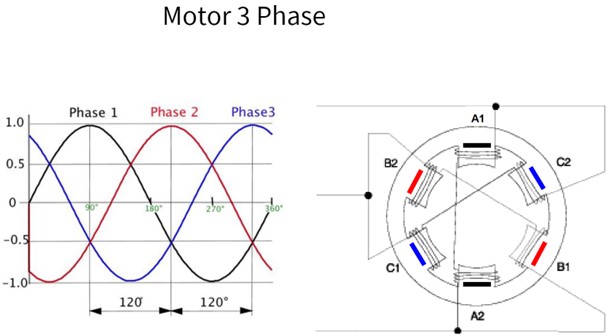

While there are simple single-phase examples, most motors you see in any industrial process or HVAC process have three-phase motors. Three-phase motors are similar, each individual wave on a three-phase motor looks similar to the previous example. The three of them are overlapped on three incoming lines. Because of this, you can use them to more precisely control how fast the motor is turning.

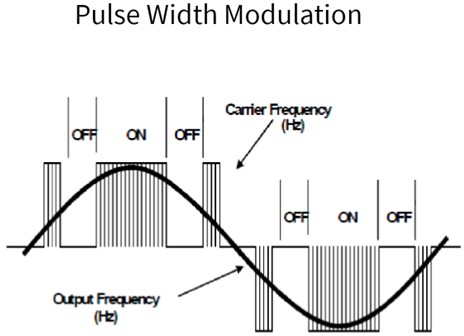

Pulse width modulation’s role in motor control
Pulse width modulation is what we use to control how fast the frequency is sent out to the motor. The previous example I mentioned was just a simple on-off example. But really what happens is that we turn the positive transistor on and off repeatedly. The longer we turn it on, the more voltage is sent out and the more positive it becomes. We eventually gated on almost 100% of the time to meet the peak of the wave, then, we start to slowly bring it back down. After it is back to neutral, we start slowly gating on the negative until it becomes almost entirely negative then we slowly bring it down, bring it back up to zero, and it causes the wave to repeat.
Motors and drives with pulse width modulation.
This process of how fast these pulses come out is called carrier frequency, and it’s called pulse width modulation because we modulate the width of the pulses to actually change the frequency. This will allow us to change not only the frequency, but the overall average voltage that gets sent out to the motor.
