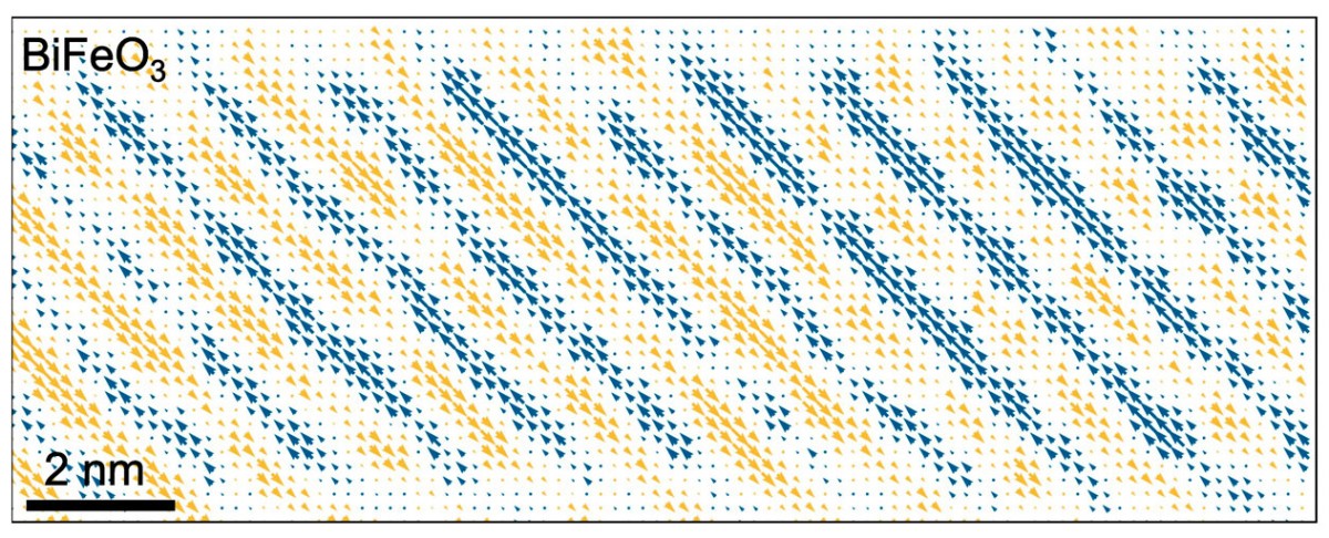

Like their better known magnetic cousins, ferroelectrics and antiferroelectrics are a class of material that has bits of information, called dipoles, arranged in a pattern. In ferroelectrics, the dipoles are oriented in the same direction. In antiferroelectrics, the dipoles alternate, i.e., up, down, up, down. Since the adjacent dipoles cancel each other out, the material has no net polarization.
Initially, the researchers set out to experiment on thin films of bismuth ferrite – a ferroelectric with the highest polarization of any known material. They stacked alternating layers of bismuth ferrite with other insulators to create a structure resembling the exquisite torte of a European baker, except that the individual layers of this ferroelectric sandwich are each less than a thousand times thinner than the diameter of a human hair. As the ferroelectric layers got thinner, something quite unexpected happened. The researchers discovered that their ferroelectric with super high polarization was suddenly transmuted into an antiferroelectric with no net polarization. In so doing, a previously unknown ground state that would never have been possible in a bulk crystal was born.
“Normally, we always study the most stable form of a material – its lowest energy state,” said Mundy. “By using our thin film technology, we found that it became possible to stabilize what is normally an inaccessible higher energy state. In this case, that higher energy and previously unknown state has quite useful properties.”

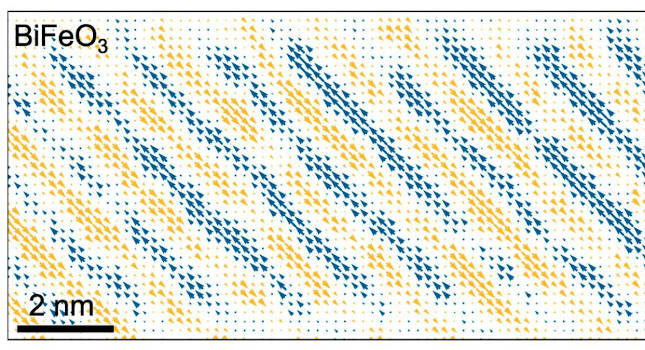

Working with David Muller, the Samuel B. Eckert Professor of Engineering, the team was able to take a deeper look into the material’s “hidden” state with an electron microscope pixel array detector (EMPAD) capable of seeing atoms at record resolution. This allowed the researchers to see the electric fields inside the material and, for the first time, image the polarizations of an antiferroelectric’s dipoles.
The behavior of these dipoles is essentially a “battle of two giants,” according to Schlom, with the ferroelectric material attempting to polarize the neighboring insulating layers in the stack, and the neighboring insulating layers trying to resist being polarized. To understand these electrostatic interactions, and the theory that explains the new antiferroelectric they stabilized, the Cornell team worked with collaborators from Harvard; Pennsylvania State University; University of California, Berkeley; ETH Zürich; Oak Ridge National Laboratory; and the Leibniz Institute for Crystal Growth.
“It’s hard to see metastable things; even the theorists hadn’t realized that bismuth ferrite could assume this form,” Schlom said. “But Julia saw it and, with electron microscopy, she was able to map the polarizations and see that, wow, it looks, smells and feels like an antiferroelectric. With clues of its existence, the theorists were able to precisely describe the structure and stability of this new ground state and establish how electrostatics perturbs the energetic landscape to make this antiferroelectric form the stable state.”
This image shows the alternating electrical dipoles in a newly formed antiferroelectric that was created by stacking layers of bismuth ferrite with other insulators. Courtesy: Cornell University
