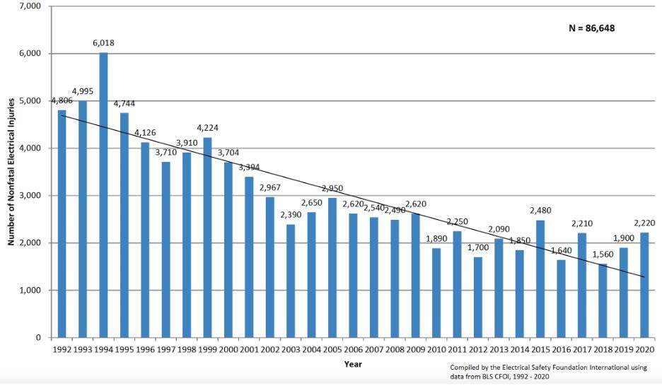

Figure 1 shows significant reduction in nonfatal lost time injuries fatalities from exposure to hazardous electrical energy, and the downward trend appears to have flattened in recent years. The flattening trend could be incorrectly interpreted that the U.S. may be at a theoretical limit in reducing serious electrical injuries.
Figure 1: Lost time injuries from contact with or exposure to electrical energy in the U.S. 1992 to 2020. Courtesy: Electrical Safety Foundation
