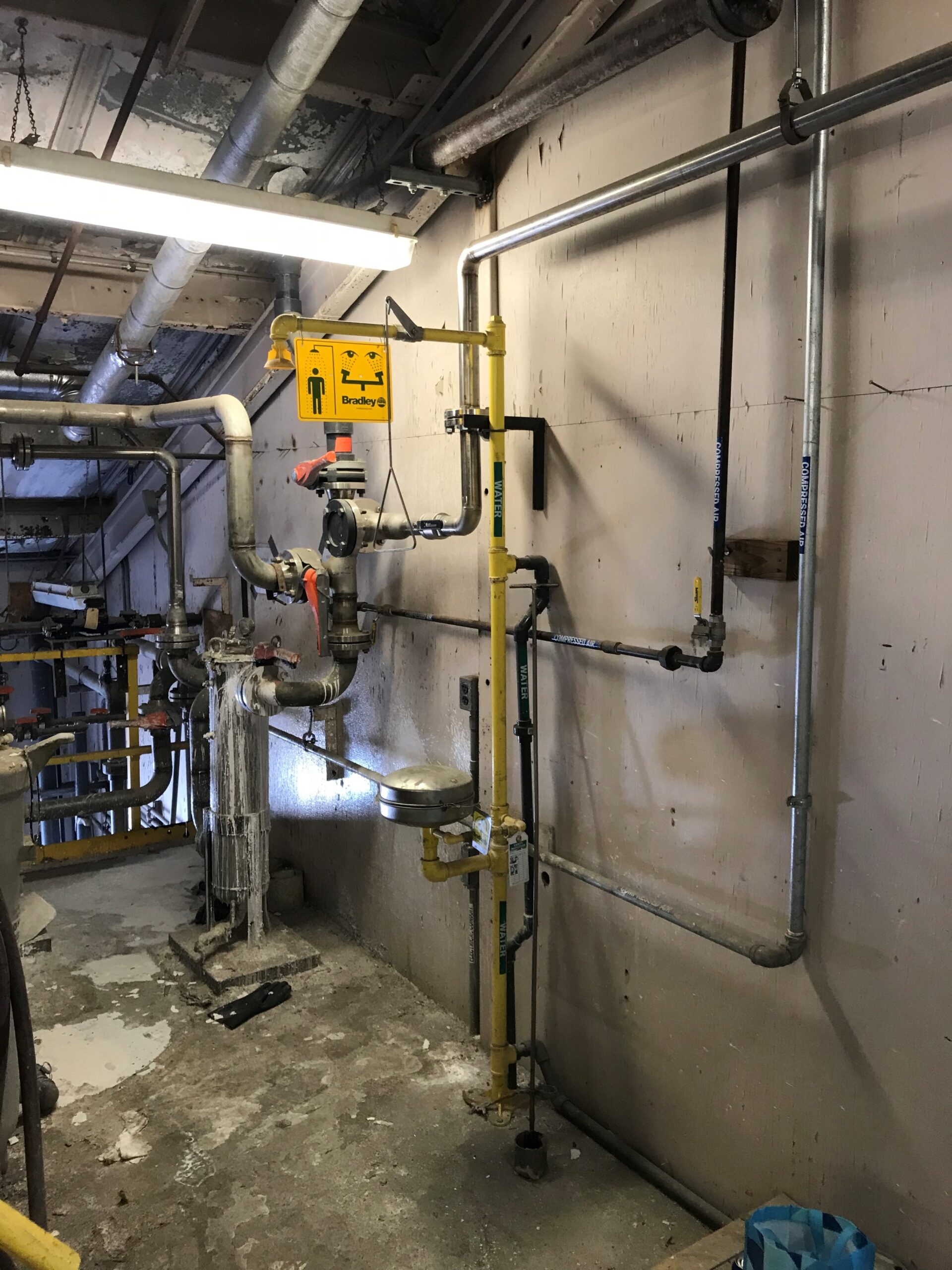

Figure 1: Emergency equipment incorrectly plumbed with nonpotable cold water without a means of providing tepid water per ANSI. Courtesy: Haley Ward Inc.
