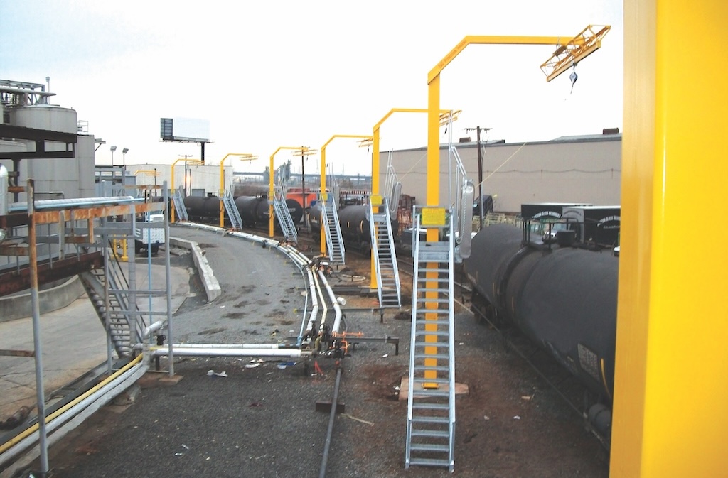

Rigid Rail TD3 Truss fall protection system in use in rail yards.
Rigid Rail TD3 Truss fall protection system in use in rail yards. Courtesy: Diversified Fall Protection
