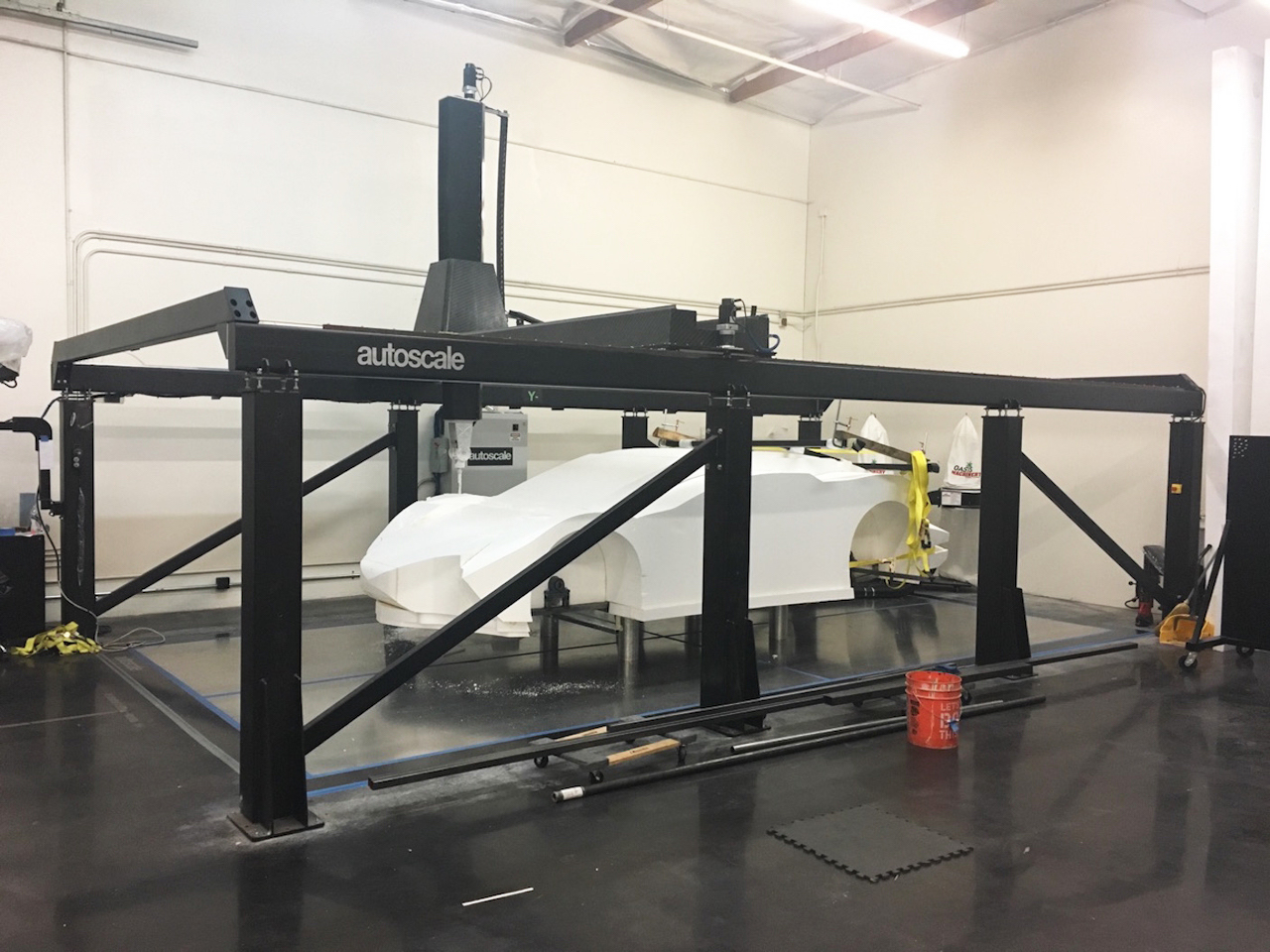

Applications ranging from CNC machines to material handling require accurate and durable linear motion systems. Courtesy: Thomson Industries, Inc.
