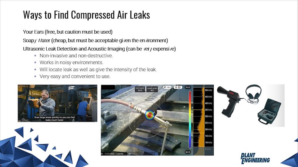

How do you find these compressed air leaks? Well, one way you can do it is just with your ear. If the plant is down over the weekend or on a holiday, you can walk around and you’ll hear some big leaks. Believe it or not, sometimes some of those leaks can be difficult to locate.
If you can hear it by not find it, the next best thing to do then is soapy water. But soapy water, of course, can be messy and in environments like food production, you wouldn’t want that.
Ultrasonic leak detection is good at finding the general location of a leak and it’s even good at giving you a sense of how big the leak is in terms of small, medium and large. But the latest, greatest thing that’s come out is called acoustic imaging, which is really cool.
Figure 6: There are three main ways to find compressed air leaks. Courtesy: CFE Media and Technology
In Figure 6, lower left, you can see a picture of this guy’s holding one. Basically, it consists of a lot of little microphones that read into a device. The device then transmits that sound pressure level or decibels in the frequencies that they’re at. You can see in the middle picture, you can see there’s a leak there on a connect. That’s like a quick release connect.
It then shows you the intensity of the leak off to the right and the frequencies. Most of us know that humans don’t hear much above about 20 kilohertz. These devices can hear up in the upper range of 50,000 hertz. You can see in this instance that this leak has a very high intensity just above 20 kilohertz. You wouldn’t hear it, but the leak detector can find it.
It’s a very, very handy tool that they can be expensive, but if a company buys one, they’re good for many years. They will pay themselves back tenfold very, very quickly.
