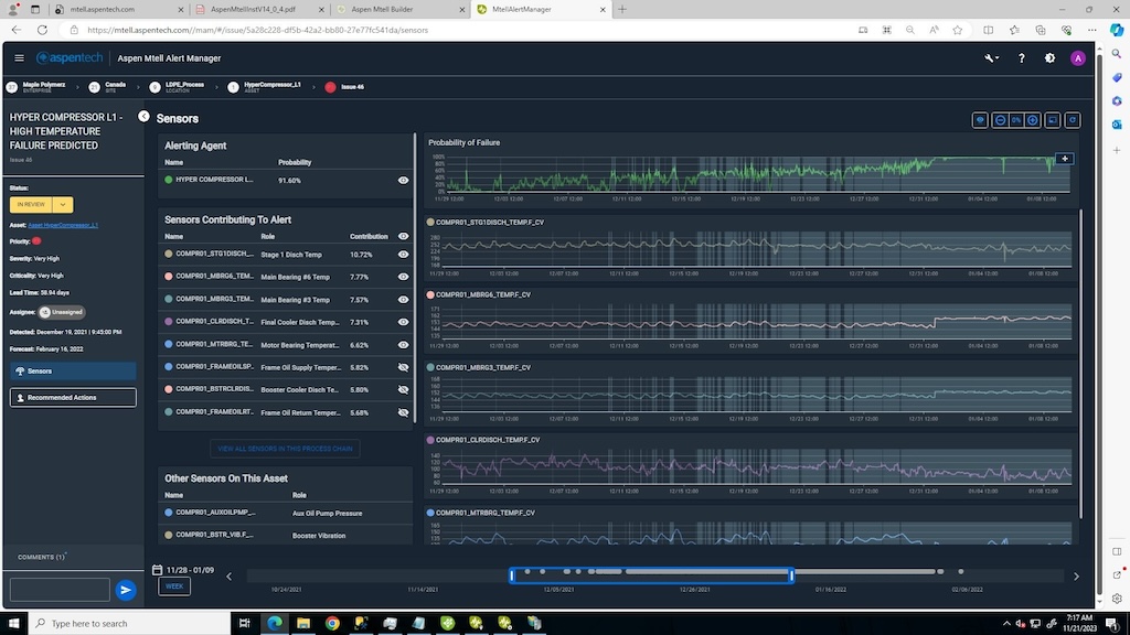

Pratibha Pillalamarri: Maintenance tasks can be prioritized by evaluating equipment criticality based on production, safety and environmental impact. These include:
  • Prioritizing critical assets to minimize disruptions
  • Utilizing predictive maintenance solutions to detect issues as they form
  • Scheduling proactive tasks guided by predictive alerts
  • Assessing risks associated with maintenance and prioritizing accordingly to ensure safety and continuity
  • Considering resource availability for efficient task completion
  • Performing cost-benefit analyses to prioritize tasks that result in highest performance and reliability improvements while reducing downtime.
This cohesive approach enhances equipment reliability and efficiency by leveraging solutions that assess criticality, quantify risks, provide prescriptive guidance and optimize maintenance scheduling.

Pratibha Pillalamarri: In one case, OCP Ecuador utilized a prescriptive maintenance solution to enhance the availability and reliability of pumps and generators. Within six weeks of implementation, they achieved impressive results, including a 20% increase in uptime and a 25% reduction in annual maintenance expenses. The solution also extended the camshaft lifespan from 20,000 to 50,000 hours, leading to substantial cost savings.
In another, a large chemical company in Asia implemented a prescriptive maintenance solution across two complexes, deploying over 200 live agents to protect various equipment such as compressors, pumps and reactors. The solution provided early warnings to prevent unplanned shutdowns, enabling production loss avoidance and shutdown prioritization for maintenance planning. The estimated annual value protected by avoiding downtime reaches up to $3.6 million.
