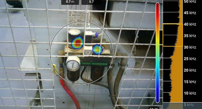

A more efficient way of finding and recording leaks has recently been developed by Fluke Corp. A leak detector instrument, called the ii900 Sonic Industrial Imager, uses a video camera to provide a live image, and an array of 64 different directional microphones to create a “heat map” of ultrasonic emissions on top of the visual display (see Figure 1). This device brings new meaning to the old saying “a picture is worth a thousand words.” Having an image representing both visual and audible signatures emitted by a leak makes the detection exercise a much easier task.
In using the Imager, the operator also “points and shoots,” but in this case the ultrasonic emission shows up as a live feed on the onboard video screen as a colored spot, making the location identification much quicker. As the operator gets closer to the leak, the location becomes easier to identify, even when shooting through protective screens or pointing at locations out of reach without a ladder. When shooting among other ultrasonic emitters, like a bench full of active compressed air powered grinders, the leak shows up as a consistent spot on the screen, with the tools being intermittent, so it is easy to differentiate. Reflections, which can cause time consuming “wild goose chases” with typical audible only detectors, are easy to separate from the leakage, moving the camera from side-to-side moves the location of a reflection, but not the image of an actual leak.
In using the acoustic imager, the first-time operator is impressed at the speed at which leaks can be detected and positively identified. The built-in video camera makes it easy to record a close-up still picture or video of the leak, which is stored on the device memory for later download. The imager software has the capability of automatically measuring the sound level in decibels, and the distance to the leak by triangulation. Using this information, and entered in pressure information for the leak, an estimate of the leakage flow can be calculated for the final report. Once the leakage flow is known, using the estimated efficiency of the compressed air system, and the site power costs, the total cost of all the leaks captured can be calculated in a final automatically generated output, called a “LeakQ report.”

Throughout the surveys, the high value of the acoustic imager output became obvious. Figure 2 shows leakage of one pressure regulator in a bank of regulators. A configuration like this makes for difficult work in identifying the source of the leak if done with a standard ultrasonic gun; use of the imager found the leak immediately. Figure 3 shows the identification of a leak in a pressure regulator behind a protective screen, something that would be difficult to do with a standard gun without shutting down the machine.
