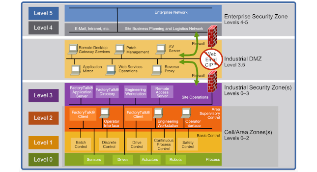

The Purdue model was created to ensure security. This is accomplished by taking a layered view of how machines and processes function and interact with each other, and how data is produced, transferred and consumed at the various levels.
What is the Purdue model?
As shown in Figure 1, the Purdue model is a guideline for industrial automation and control systems, including network and security requirements. It is the most widely used framework across industrial environments globally. Many industrial controls, data collection and SCADA systems are designed around the model, ensuring that new and existing architectures continue to adhere to it. The Purdue model also inspired ISA-95, an international standard from the International Society of Automation that defines interfaces between enterprise and control systems.
The model, in the shape of a pyramid formation represents how information flows from the shop floor upwards into high-level enterprise systems. The model separates enterprise and operational domains into different zones isolated with an industrialized Demilitarized Zone, or DMZ, in between. Built-in security prevents security breaches between Level 0 and Level 5.
The model keeps computing and networks deterministic, i.e., ensuring that networks on the shop floor remain dedicated to the control systems and do not become “flooded” with non-production related data that could result in network capacity issues that could stop the manufacturing process.
The model purports to regulate and protect required responsiveness for each layer through segmentation. Segmentation is the primary methodology to mitigate concerns over unwarranted or unwanted traffic from the IT world from disrupting fragile and untested legacy controls equipment.
The Purdue model also serves as a blueprint for IT systems to acquire shop floor data via the DMZ without compromising production or allowing capture of plant floor mechanical equipment for nefarious purposes. Cybersecurity concerns were also addressed by firewalls placed between industrial and enterprise zones, isolating data within the zones absent explicit data sharing rules.

Consider Figure 2, which demonstrates how an industrial edge computing platform can be inserted into the Purdue model.
The industrial edge computing platform sits inside the Purdue model, facilitating communications between any level as required. It is the data quarterback. It is the orchestration platform that makes it easy for systems to communicate amongst themselves.
Around the outside of the diagram, the traditional and established data flows will continue to persist as per the Purdue model, maintaining adherence to proven guidance of the model.
The Purdue model has benefits still valuable in today’s manufacturing environment. Implementing an industrial edge computing platform into the model preserves the integrity of the system while allowing flexibility that drives the foundation of a flat data collection and analytic environment that accelerates continuous improvement.
