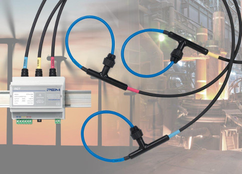

The RCTrms 3-ph current transducer delivers a convenient, safe, and accurate solution for measuring current in three phases.
The RCTrms 3-ph current transducer delivers a convenient, safe, and accurate solution for measuring current in three phases. It features a thin, clip-around, flexible sensor coil and provides accurate true RMS measurement with 4 to 20mA or 0 to 5 V output, enabling simple installation with PLCs, SCADA systems, or automation equipment. With 18 current ratings options from 100A to 50,000A, and a choice of 300-mm, 500-mm, 700-mm, or custom coil lengths, the RCTrms-3ph can be used in many applications and connected to a wide variety of SCADA systems, PLCs, data loggers, protection equipment or motor controllers. The clip-around coil design allows fast and easy positioning, and provides accurate results without needing to be centralized around the conductor. An isolated BNC-BNC cable-split option is available to ease installation, such as when threading through existing conduit.
