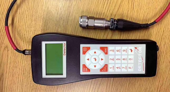

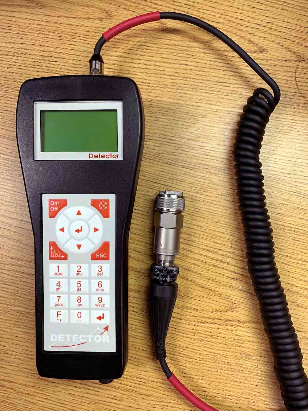

An accelerometer is used to measure an air compressor’s vibration signature. Courtesy: Hitachi Global Air Power US, LLC
To conduct the analysis, a small handheld vibration tool with an accelerometer is placed (via magnet) to various areas of the air end as well as the motor and other select areas of the compressor. The technician will then take readings in up to three directions– vertical, horizontal and axial along the measuring points – and may even take several readings from one measuring point. Some vibration accelerometer devices read in all three directions – vertical, horizontal, and axial – at the same time, but some analysts prefer using a single direction as it tends to be more accurate. Additionally, the data collected can be more dependable if the measuring points of the routes are marked so that the future routes are taken in the same locations. Once the machine reaches its operating temperature and stabilizes, the compressor will then need to run at rated pressure and full load for the entire time the readings are being taken — with the usual environmental conditions and temperature. The handheld analyzer along with the accelerometer measure the machine’s vibration in the Fast Fourier Transform (FFT) spectrum and converts the data gathered into the FFT spectrum by the algorithm. This FFT data is recorded at each measuring point of the compressor and route and sent to an analyst to evaluate the readings.

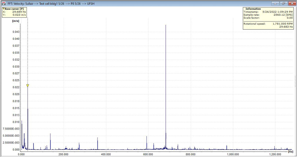

The analyst will view the collected data on spectrum and time wave form plots and render a report. The vibration levels recorded on the graph will indicate what components are performing normally, which are changing (if historical data is available), and what is beginning to fail.
Every component from the ball bearings to the gears and rotors has its own frequency. By reviewing the frequency readings and studying the peaks and valleys on the graph, analysts can pinpoint an issue by a shift or abnormal component frequency as vibration peaks will become more pronounced or elevated when there is a problem. The process is extremely accurate. If the analyst can’t determine exactly what is at issue, they can come very close to providing a strong indication of the issues brewing.
The final vibration report provides an overview of the health of the compressor and includes a detailed summary of where the various parts and components are in their life cycle. Most importantly, the report can inform the user when an issue will become serious or a failure is likely. This will allow the user to schedule maintenance at a time most convenient to the overall operation. Instead of a bearing failing during a busy or critical production window, plant management can shut down operations at a pre-determined time and coordinate repairs to other areas of the factory at the same time. Scheduling this kind of maintenance also ensures that the parts needed for the repairs are in-house. Unplanned shutdowns can stretch into days or even weeks if parts are unavailable.
Charted vibration data can help reveal a compressor’s health and pinpoint failing parts, including predicting when those parts may fail. Courtesy: Hitachi Global Air Power US, LLC
