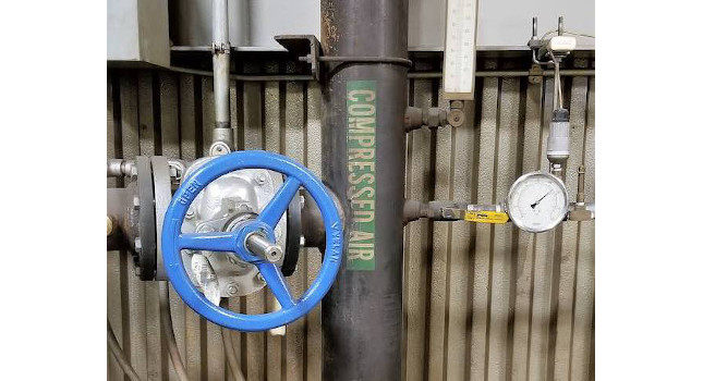

Compressed air requirements fall into two main categories: air quality and air pressure. Higher-quality air requires better filtration and treatment, which both equipment costs and energy costs, as air must be pushed through these additional components. Higher-pressure air requires higher energy costs as the compressor must work harder to pressurize every cubic feet per minute of air.
A typical evaluation might estimate the efficiency of the system in terms of kilowatts of power required per 100 cfm of air delivered.
A major way to lower the kilowatts per 100 cfm is to lower the pressure drop in the system. System pressure is determined by the required pressure at the most critical process. The minimum pressure required at a piece of equipment is typically outside of your control; it is simply a process requirement. The compressors must generate air at that critical pressure plus whatever pressure losses must be overcome between the compressor outlet and that process. Lowering the pressure drop allows you to lower the compressor discharge pressure.
If you have several pounds per square inch of pressure drop in your piping system due to undersized piping, you are wasting energy. Or, if you are pushing air through unnecessary filtration and other components, you may be forced to set your discharge pressure unnecessarily high. Lowering the compressor discharge pressure by 10 psi will save approximately 5% in energy consumption.
Piping pressure loss evaluation is straightforward; pressure drop can be measured from point A to point B, which allows you to determine if the drop is excessive and how much it could be lowered by increasing the pipe size. A contractor can provide a price for upsizing that section of piping; the piping replacement will either be worth the cost or it won’t, based on the expected return on performance.
Determining how to minimize filtration losses is less straightforward. To do this, you need to know what air quality is required at the various processes in your facility. Many compressed air users in a factory, such as pneumatic tools and some forms of conveyance, do not have stringent air quality requirements. Other applications — such as instrument air, food processing or testing — require very high-quality air.
Compressed air quality levels are defined by ISO 8573-1. This standard specifies purity classes of compressed air in three categories: particles, water and oil (see Table 1).
Particulate classes can be achieved by filtration. Higher-quality filters typically have a higher pressure drop. To push the air through extra filtration, the discharge pressure of the compressor must increase, requiring higher energy cost per cfm.

As shown in the engine test cell facility, the compressor pressure setpoint should be based on maintaining minimum inlet pressure required at critical process. High pressure drop between source and critical process will require increasing the pressure setpoint, which costs energy. The pressure sensors installed in this facility allowed us to evaluate the pressure drop at remote areas of the factory.
An example of data, measured in pounds per square inch, is shown in Figure 1. Location A was in the main compressed air header near the compressors. Locations B and C were in remote areas at opposite ends of the factory.
The collected data showed a pressure loss in the piping system out to the ends of the factory, as expected — an approximate 1 psi drop to location B and an approximate 2 psi drop to the farther location C.
The data showed pressure swings in the system as the load changed, particularly during first-shift manufacturing hours. Interestingly, the pressure drop to remote areas — i.e., the difference between A and B or A and C — did not vary greatly throughout the production day. The swings in pressure were relatively uniform across the entire system.
This indicated that the primary consumer of compressed air causing the pressure fluctuations was near the main trunk line, thus impacting the pressure of the entire system, not simply a remote area. This also indicated that pressure losses in main piping to remote areas was not a limiting factor in capacity and increasing the main piping size would not significantly improve performance; less than a 1% efficiency gain was anticipated.
