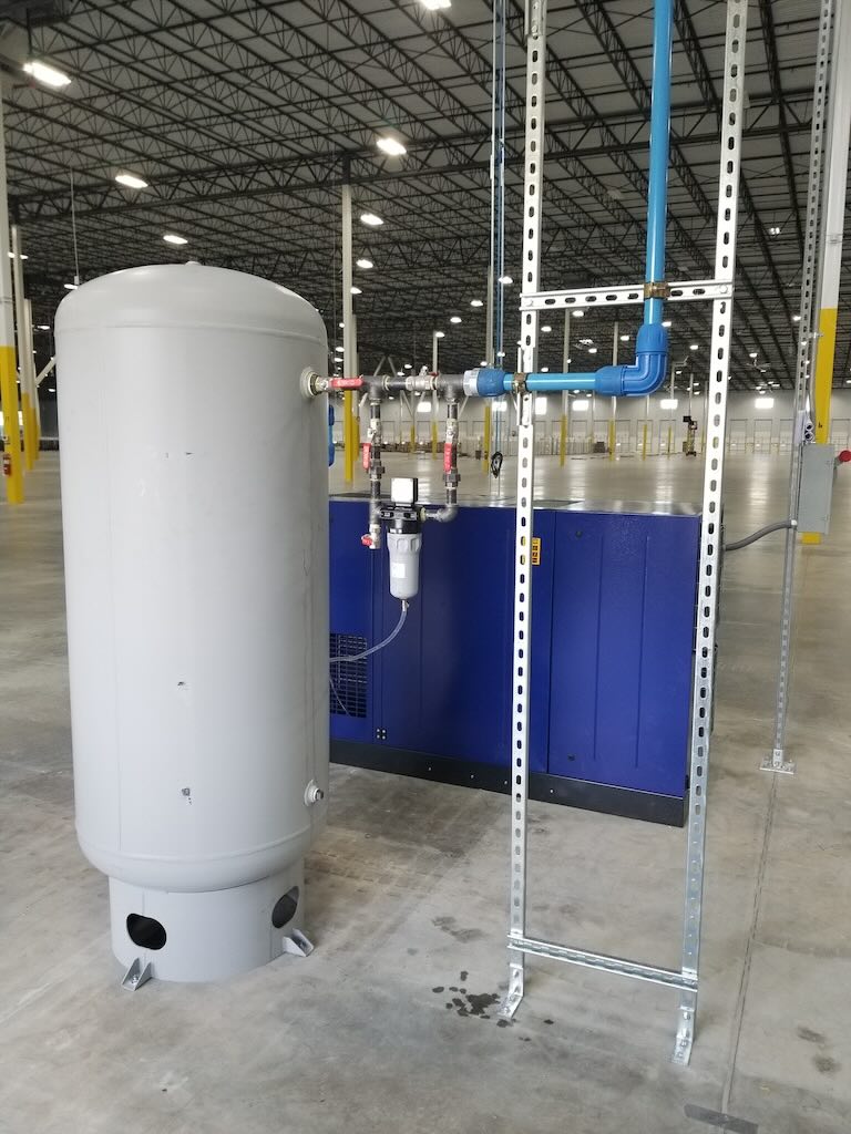

Figure 1: Aluminum piping connection to air compressor with compression fittings.
Figure 1: Aluminum piping connection to air compressor with compression fittings. Courtesy: Velocity Conveyors

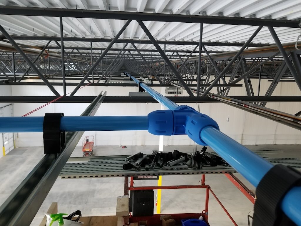

Figure 2: Aluminum piping’s lightweight qualities enable safe lines across existing ceiling structures.
Figure 2: Aluminum piping’s lightweight qualities enable safe lines across existing ceiling structures. Courtesy: Velocity Conveyors

1. It’s lightweight and has a low installation risk
The lightweight properties of aluminum compared to steel or copper alternatives make installation a breeze. This allows for less installation labor, as one person can lay more piping in less time than large teams installing alternative materials with more complex installation methods.
Aluminum piping also allows for faster, simpler adjustments in the future. These adjustments can even be made by in-house staff. No soldering, welding or brazing means no hot work permits or specialized, outsourced labor.

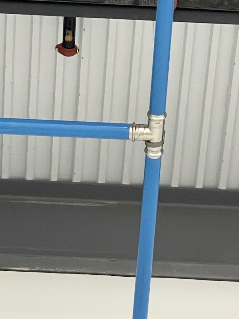

Figure 3: Aluminum piping with press fitting.
Figure 3: Aluminum piping with press fitting. Courtesy: RapidAir

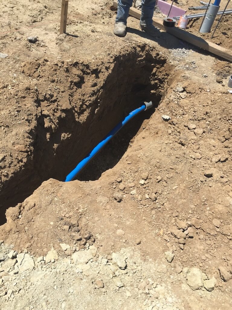

Semi-flexible compound piping
Recently innovated compound piping couples lightweight aluminum with an external polymer coating. This new form factor enables flexibility and bend radiuses that aren’t possible with other compressed air piping solutions. The semi-flexibility eases installs (no exact measurements required) along the twists and turns of the production line.

Press fittings
Through a unique process of pressing directly on the aluminum piping, pipe sections join in seconds without separate fasteners or adjustment. This represents a genuine breakthrough for compressed air piping install efficiency. Press fittings stainless steel material give them a sleek, metallic look that comes with inherent corrosion resistance, making them the superior option for installations that are subject to the elements. Press fittings also are capable of handling higher PSI than compression fittings.
Figure 4: Semi-flexible compound aluminum piping is designed to withstand burial in dirt or concrete.
Figure 4: Semi-flexible compound aluminum piping is designed to withstand burial in dirt or concrete. Courtesy: RapidAir
