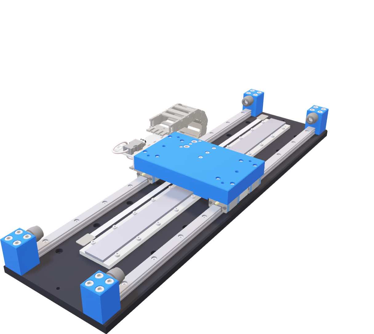

1. Linear motor stage
Let’s begin with a definition of a linear motor stage. The distinguishing feature of a linear motor is the load moves without any mechanical power conversion. The linear force generated by the motor coil is directly connected to the load. In a linear motor, the motor coil propels itself along the magnet track. The motor coil is attached to the carriage, sometimes called a “slide.”  The load is bolted directly to the carriage. The carriage is held in place by linear bearings with rails secured to the base. The linear bearings are the only point of mechanical contact and frictional wear, apart from and the bending of cables. This simple fact results in huge performance benefits for a linear motor stage. The position of the carriage is reported to the control system through a linear encoder. The encoder has two parts – the scale mounted to the base, and the moving read head. Other parts of a typical linear motor stage are the cable management system and end stops.

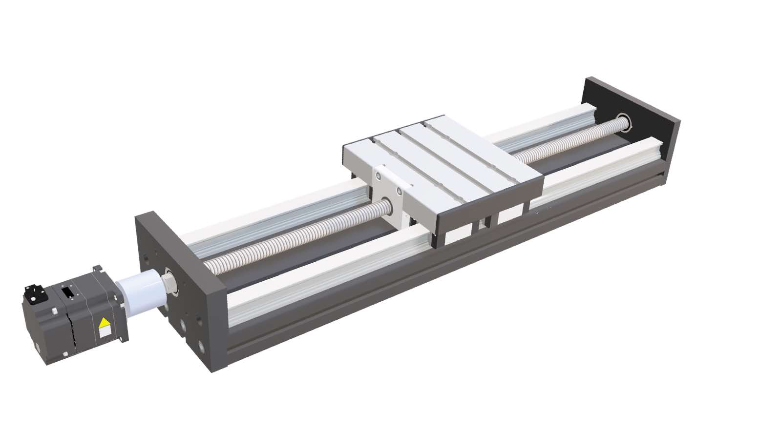

2. Ballscrew actuator
The ballscrew is the standard go-to actuator for a wide variety of applications.  These also have a carriage that moves on linear bearings and rails. But the force to move it is transmitted through a nut from a rotating screw. This nut is often comprised of a system of enclosed recirculating ball bearings which minimize friction. The screw is driven by a rotary motor. The encoder in the motor provides position feedback to the control system. The screw is held in place with bearings at each end and connects to the motor through a flexible coupling.
Figure 2: Example of ballscrew actuator. Courtesy: Yaskawa

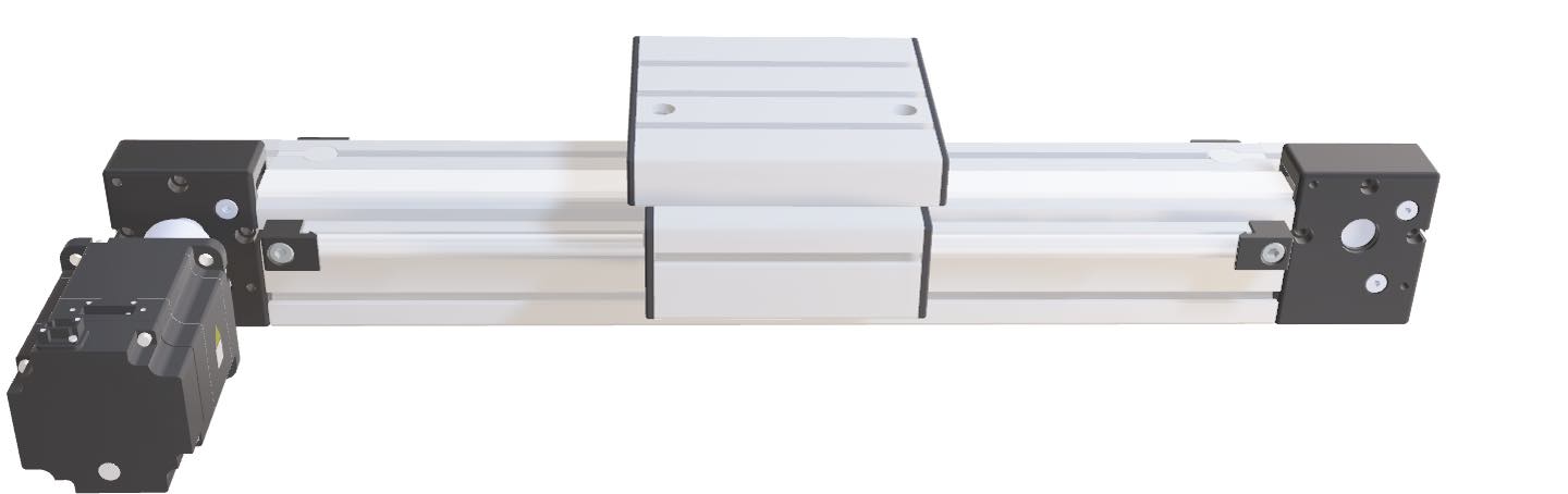

3. Belt actuator
A belt actuator also has a carriage which moves on rails with linear bearings. This carriage is driven by direct connection to a timing belt riding on two pulleys.  The pulleys are held in place with bearings and connect to the motor with a flexible coupling. The encoder on the motor provides position feedback to the control system.

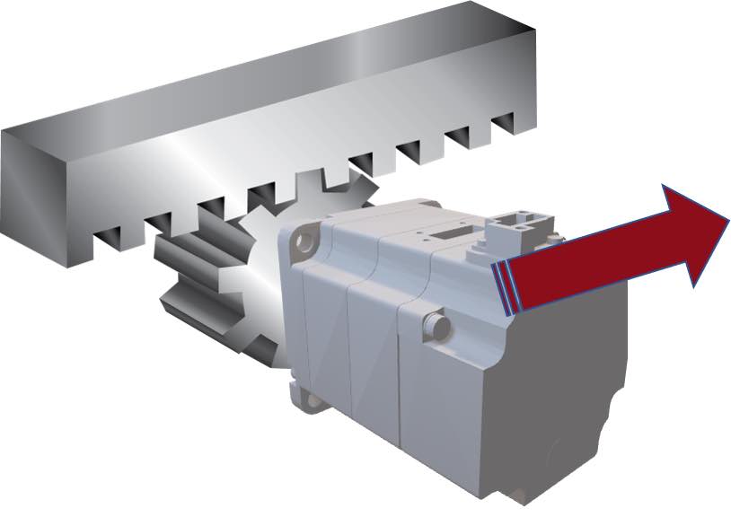

4. Rack and pinion
A rack and pinion system is often comprised of a motor that drives a pinion, moving itself along a fixed rack, like a train on a track. The motor is mounted to the carriage, driving the pinion through a gear reduction to move the entire assembly.

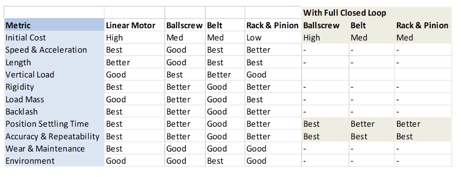

Comparative metrics for linear actuation
Now let’s look at how each of these technologies compare in metrics such as initial cost, speed and acceleration, and other factors as listed in figure 5. It is important to define each of these metrics before discussing the strengths and weaknesses of each technology. This is not an evaluation, but it does represent general industry trends.
Figure 5: Comparison of mechanisms by different metrics. Courtesy: Yaskawa
Linear actuator initial cost
Let’s start with the bottom line – initial cost. The linear motor often has the highest overall performance. Stands to reason, therefore, the initial cost is also generally higher than other technologies. Ballscrews are less expensive than linear motors. However, they are more expensive than belt actuators, which tend toward the low end of the cost spectrum. Rack and pinion is tough to compare. These tend to be used in large systems with much larger and heavier payloads. The cost of rack and pinion is lower at that scale than linear motors, ballscrews, and belts. At a smaller scale, the advantage is often less distinguishable.

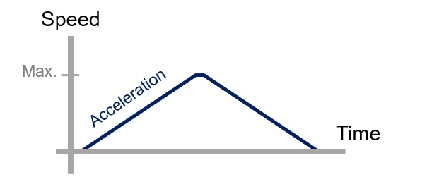

Speed and acceleration for linear actuators
Motion control systems have the need for speed. Faster better and more means a quick return on the investment. This translates to not just top speed, but fast acceleration.
The linear motor can accelerate quickly to reach high speeds, typically around 5 m/s. It is the performance champion for the mechanism with both high speed and acceleration.
Figure 6: Speed and acceleration vs. time. Courtesy: Yaskawa
Screw driven actuators can have strong acceleration, but above the critical speed a screw will oscillate. This critical rpm design limitation is dependent on the diameter and length of the screw. The screw lead can be designed to move further for every turn. This increases the linear speed for the same motor rpm. But it also means more motor torque is required to move the same load. It also may negatively affect the repeatability and accuracy (more on that later). With a faster screw the reflected inertia also increases, thereby reducing control loop stability and increasing settling time. As a result, a larger, more expensive motor may be required. Occasionally these constraints have a snowball effect resulting in a very oversized or even impossible solution.

Ballscrew length is limited once again by the critical speed of the screw. Longer screws begin to oscillate at a lower RPM, and negatively impact tuning by lowering resonant frequencies. We’ll discuss this more later. A larger screw diameter helps to achieve useable speeds. This means large motors are required to drive the longer screws, even with a small load, unless the speed is very slow.

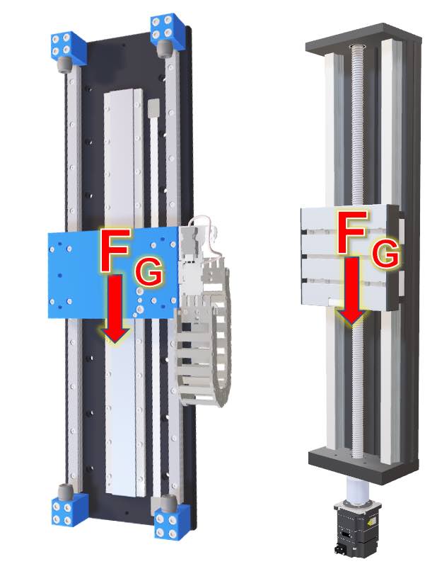

Vertical load for linear actuators
Horizontally oriented motion is the most common, but vertical or inclined axes are required in many applications. This means the force of gravity is constantly pushing the load down. This force must be overcome by the motor while the axis moves or holds position. When the machine powers off, a braking system can prevent the vertical axis from falling.
Figure 7: Force of gravity on vertically-oriented linear motor stage and ballscrew actuator. Courtesy: Yaskawa
Rotary holding brakes are commonly found in servomotor designs to lock the motor shaft when powered down. This makes the ballscrew or belt an excellent choice for vertical loads. A vertical rack and pinion also works well for the same reasons.
Linear motors are a bit more complex with vertical loads. A counterbalance or linear holding brake should always be used. A linear holding brake may be mounted externally or fit under the carriage to brake against the rail.

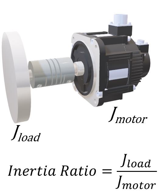

Rigidity and resonant frequency are related to load mass. This is summarized in a key performance metric called the load to motor inertia ratio. Servo systems are commonly sized for a load to motor inertia ratio less than 10:1 for acceptable control of the load by the motor through the flexible coupling. Load mass is one of the most elements in mechanical system selection, so it is important to understand these well.
Load to motor inertia ratio is more accurately called mass ratio and is of less importance in a linear stage because the motor is directly coupled to the load. The load on a linear motor is more like an extension of the carriage itself. A linear motor has no coupling to reduce the rigidity of the system. Load mass is nevertheless important for linear motors, as it limits the acceleration and deceleration rate according to Newton’s Law. It also affects linear bearing life. Low friction also means almost all of the power to stop a moving load must be supplied by the electronic drive system, which can also limit the maximum load.

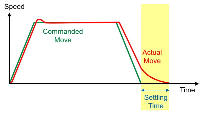

Settling time for linear actuators
Rigidity, load mass, inertia ratio, and backlash are all interrelated factors that worsen the position settling time of a mechanism. Position settling time is the time delay between the end of the commanded move and when the mechanism stops. Reducing this delay is especially important for applications with many short moves. Waiting for the machine to stop can represent a significant fraction of the cycle time.
The settling time in a linear motor can often be reduced to zero with good tuning, due to its high rigidity and zero backlash. It may be necessary to mitigate vibrations originating in the load itself. Achievable settling times for the ballscrew and belt usually follow the level of mechanical rigidity and backlash with screws often outperforming belts. Same goes for rack and pinion, although fast moves and low settling time are typically not the focus with these larger machines.
Figure 9: Settling time of actual move. Courtesy: Yaskawa
The position of these mechanisms is measured through the rotary servomotor’s encoder. The encoder may indicate the load has settled with a low settling time. What that means is the encoder has stopped moving. The load may still be in motion and not yet settled or experiencing vibration and oscillation. Rigidity and backlash interferes with the measurement of settling time through the encoder of a rotary servomotor. However, in the linear motor, the encoder is fixed to the load itself, reporting the true settling time of the load.

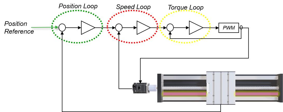

Full closed-loop linear actuation
So why not compensate for the shortcomings of ballscrews, belts, and rack and pinion mechanisms by adding a linear encoder? This is possible, and one term for this in the industry is full closed-loop operation. This allows the position loop of the rotary motor to be closed by linear encoder feedback.
However, adding a linear encoder adds significant costs and complexity. The linear scale must be accurately placed. The read head clearance to the linear scale must be accurately aligned. A cable track for cable management is needed on the carriage. Most servo amplifiers don’t support a second encoder input without additional hardware cost. Servo tuning also will be affected and must be completed again.
Figure 10: Full closed-loop linear encoder on ballscrew. Courtesy: Yaskawa
If the performance of an existing system must be improved, then full closed-loop control is a viable option. It is generally not a significant cost savings compared to using a linear motor in the first place. Adding full closed-loop control will improve repeatability and accuracy, but does not do much to improve rigidity, settling time and wear. For new applications, it is important to consider a linear encoder on a belt, ballscrew or rack and pinion will really save money in the long run.

Selecting the right actuator
When selecting the right actuator for an application, it is important to consider long-term cost and performance. There are applications with specific constraints which logically eliminate a linear motor from consideration. Other applications have long been the strength of linear motors – long stroke or high speed, fast acceleration, precision and accuracy.
There’s a middle ground where linear motors are often overlooked in favor of the traditional solutions of ballscrews, belts, or rack and pinion. Solving these applications with linear motors can save money in the long run while providing exceptional and stable performance over the life of the machine.
