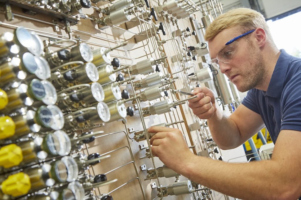

Whether you need a relief valve or other type of fluid system valve, a variety of considerations abound when making a selection. You want to get that selection right, as choosing an improper valve could lead to avoidable safety risks, poor performance and even increased downtime (see Figure 4).
A helpful tool when choosing a valve for your system is the STAMPED method, which stands for size, temperature, application, media, pressure, ends (or fittings) and delivery. This method provides a framework to help fluid system designers pick the proper valve and entails:
Figure 4: When making valve selections, it is important to make the right choice to ensure safety, performance and uptime.
Figure 4: When making valve selections, it is important to make the right choice to ensure safety, performance and uptime. Courtesy: Swagelok Co.

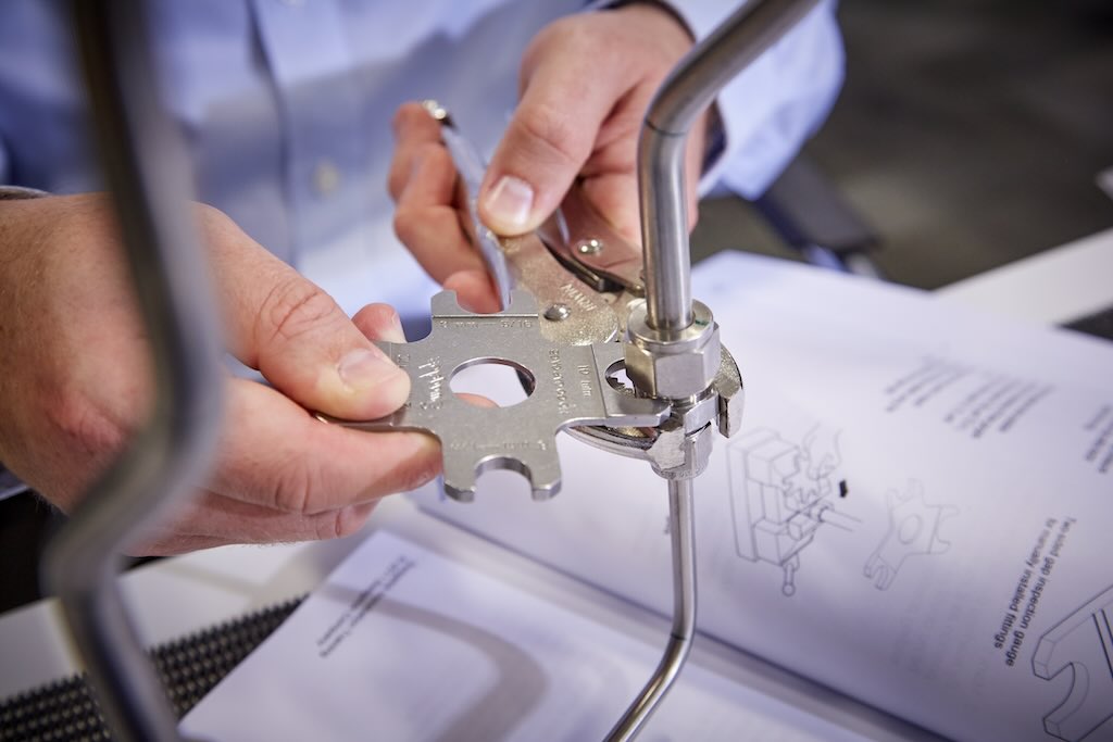

  • End connections: End connections are crucial to how well a valve will resist leaking. They include integral tube fittings, pipe threads, pipe flanges, welded ends and other options. Choosing the appropriate end connections for a valve that meet the pressure, temperature and size of a system will make installations easier and reduce the number of potential leaks (see Figure 5).
  • Delivery: Once the above factors have been considered, it’s important to ensure you can actually get your valves in hand. Look for suppliers that can source your valves on time, including specialty ones that may require more lead time.
Figure 5: Choosing the right end connections can help technicians perform easier and speedier installations, while also enhancing leak-tight valve performance.
Figure 5: Choosing the right end connections can help technicians perform easier and speedier installations, while also enhancing leak-tight valve performance. Courtesy: Swagelok Co.
