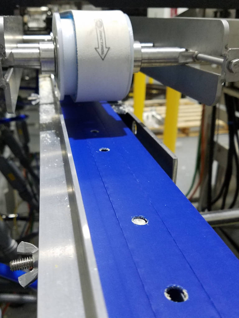

A: The scope of the project included repair of equipment designed and developed by a custom fabricator that was not working. This included examination of a multi-access feeding system, a saw and conveyor system to sort, which then tied into a wrapper/packaging system from three original equipment manufacturers (OEMs).

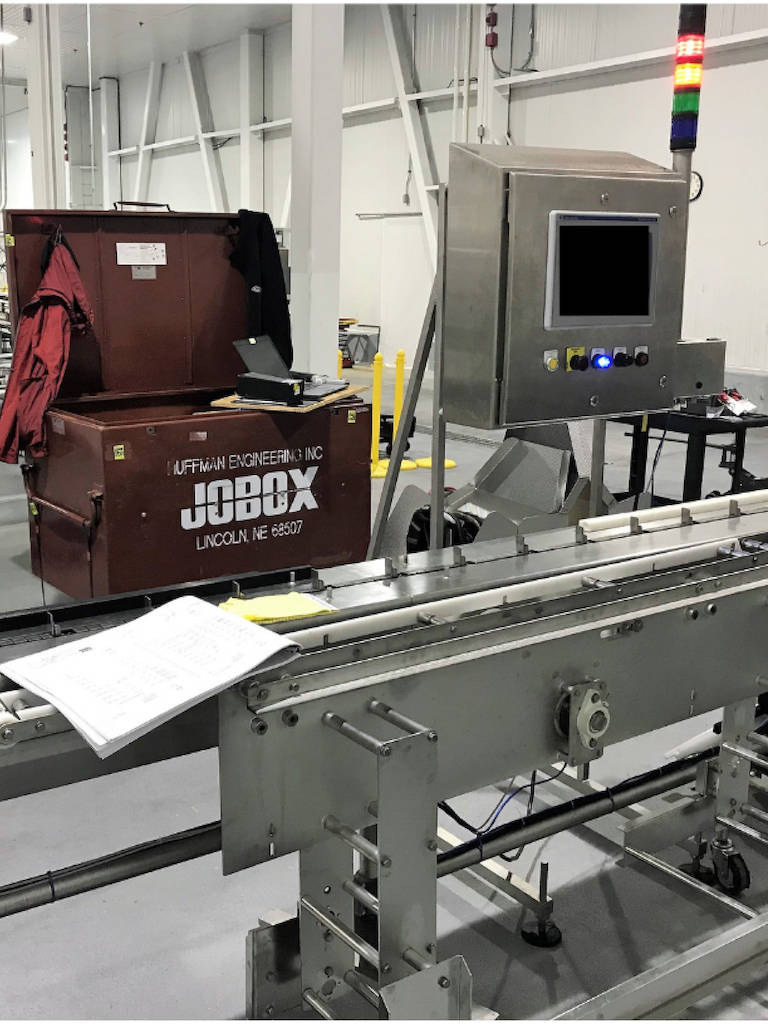

A: Because this was a mid-start-up R&D project, much of the work was done with existing hardware. In redesigning the system to integrate with three separate OEMs Huffman Engineering used one vendor’s programmable logic controllers (PLCs), variable frequency drives (VFDs), motion control, encoder, safety sensors, and smart safety relay.
Q: What were particular challenges outlined in the project?
A: Challenges with this project extended in many directions. First, the existing equipment in this mid-start-up was not working. It was originally designed using three different OEMs that weren’t equipped to talk to one another. It required a re-design of the encoder which was improperly mounted causing a noise obstacle and incorrectly giving feedback. The motor speed of the conveyor also required technical re alignment of the product once it passed through the saw. While safety hardware was put in place, it was not being utilized to its capacity in the way it was originally intended and required adjustment. The packaging/wrapper equipment used a proprietary controller restricting the ability to communicate to it and other systems. Ultimately, maintaining funding for the R&D project by meeting project deadlines was the overall challenge.

A: Resolution started with great communication between the customer and the integrator. Understanding what works, what doesn’t work and what the ultimate customers goals are is a necessary and vital starting point. Especially with an R&D project in a mid-start-up state, (as opposed to a newly designed and engineered from scratch project) great collaboration with the existing team is the key to success. Clear understanding about expectations, timeline and deadlines required for the project must be laid out initially. From there, scheduling time onsite to view the existing equipment and set up is invaluable.
One of the lessons learned through the COVID-19 pandemic is the value of technology to connect virtually, while beneficial in some circumstances, cannot replace time onsite to view and work with the equipment.
Understanding the operational environment and seeing existing equipment in process onsite allows valuable insight that ultimately proves more efficient for all projects. In this instance specifically, our machine safety certified engineers and the knowledge they brought really came into play. One part of the process required a saw and the safety implications for the people on the line were significant. This is something we would not have been as aware of without being onsite and observing the operational order of the production.
With any packaging job, building in time to test and finding out how and why an existing system is operating with all the idiosyncrasies is honestly a matter of being onsite and having highly skilled and certified engineers just work with it. From there, in this instance, we determined the need to re-design the encoder and mount it correctly on the line to prevent noise pollution, the need for consistent attention to product back pressure issues, and the necessity of providing an HMI to allow operators to continually adjust the speed and manipulate other factors so the R&D could continue.
Existing equipment in this mid-start-up was not working. It was originally designed using three original equipment manufacturers (OEMs) that weren’t equipped to talk to one another. Huffman Engineering integrated Allen-Bradley tools from Rockwell Automation: Smart safety relay, Compact Logix PLCs, Powerflex 525 VFDs, Kinetix 5700 Motion Control, encoder and safety sensors. Courtesy: Huffman Engineering

System integration and repair project included examination of a multi-access feeding system, a saw and conveyor system to sort, which then tied into a wrapper/packaging system from three original equipment manufacturers (OEMs). Courtesy: Huffman Engineering
