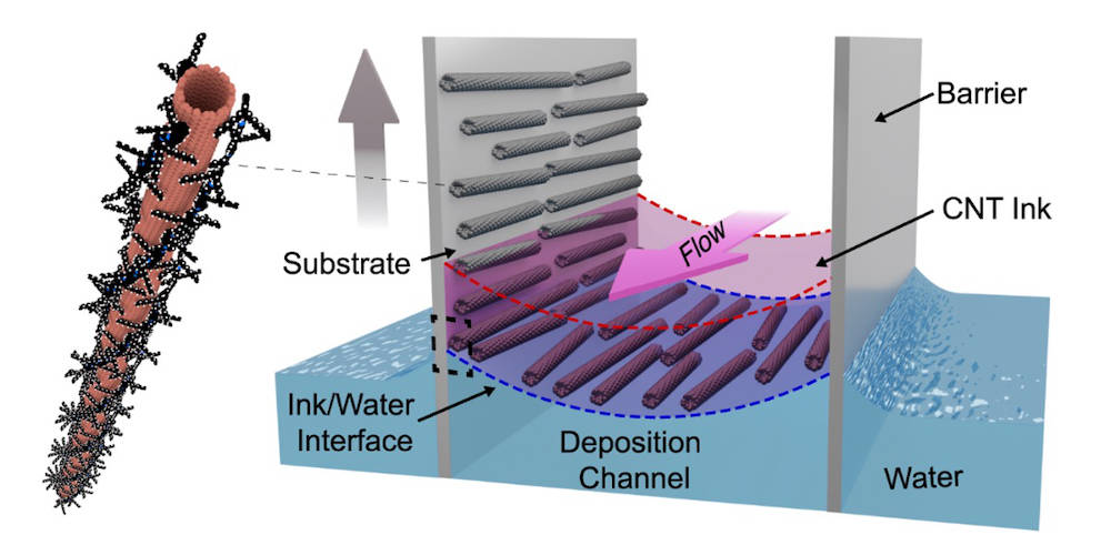

The technique was a serendipitous discovery. While trying to understand some previous research, the team deposited nanotubes suspended in a solvent over a layer of water. But the researchers noticed that the nanotubes began to self-organize and align at the interface between the liquids.
“We didn’t understand why, so this became the focus of four years of research by Katy to get to the bottom of it,” Arnold said. “Once we understood what was going on, then it could be engineered into a process that might be useful to industry.”
UW-Madison engineers have worked out a method to make orderly sheets of 2-dimensional carbon nanotubes by aligning them between layers of water and a solvent “ink.” Courtesy: Arnold Lab, UW-Madison
Using Raman spectroscopy, the team was able to confirm the nanotube density is near that needed for electronics, and using scanning electron microscopy they also determined the alignment of the tubes to be within ±6° locally. This almost ideal nanotube ordering led to excellent electrical properties that were confirmed consistent across the entire wafer.
In the fabrication technique, the team sorts and purifies commercially produced nanotubes using techniques previously utilized by the Arnold group. This purification process produces nanotubes in solvents, or nanotube inks, which they then flow at a constant velocity and thickness over a layer of water. At the interface between the ink and water, the nanotubes begin to concentrate and self-organize, forming a liquid crystal. That liquid crystal is then transferred on a substrate moved through the ink and water interface. The result is a wafer covered in trillions of highly aligned carbon nanotubes.
