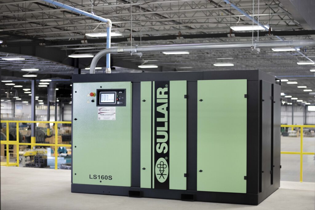

Figure 1: Compressor placement is vital to machine efficiency. Select a room that is clean, easily accessible for maintenance and repairs and temperature controlled. Courtesy: Hitachi Global Air Power
Regular audits are one of the best ways to uncover savings, often revealing complex problems hidden to the untrained eye. Audit-based action plans can cut maintenance costs by as much as 60% and reduce electrical costs by up to 50%.
The best time to audit a system is whenever a facility adds, removes or replaces equipment or when manufacturing patterns change, like adding a second shift. Even without these major changes, it’s still important to schedule an air audit every three to five years.

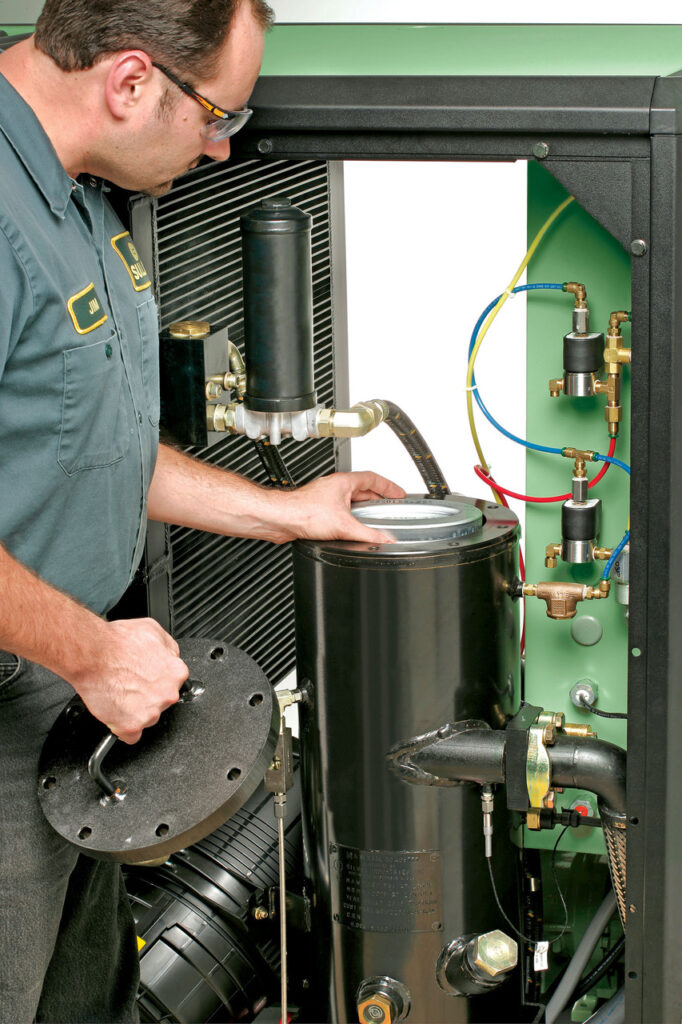

Figure 2: Regular and preventive maintenance will keep an air compressor running efficiently and reliably. Courtesy: Hitachi Global Air Power

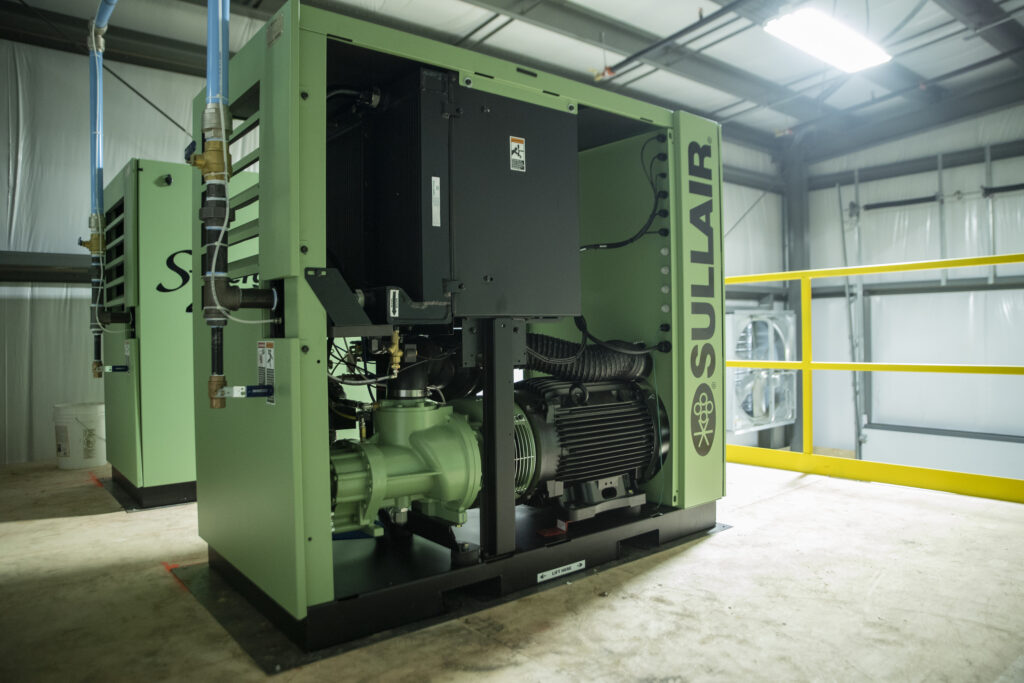

Beyond pesky leaks, piping layout and size can impact efficiency. Discharge piping should never be reduced below the compressor outlet size. Upsizing piping is often beneficial because it reduces pressure losses. Piping should also be set up to minimize sharp 90-degree elbow turns with sweeping bends or radius fittings used wherever possible.
Piping connections and materials are also critical; tying into the top of a main header prevents piping from acting like a drip leg and forcing condensation back toward the compressor. And choosing the right material for an application should be carefully considered. Aluminum piping is lightweight, noncorrosive and easy to install. Galvanized steel and copper may also be used, though each has trade-offs. Older iron pipes should be replaced, as corrosion buildup from moisture restricts airflow over time.
And do not forget about valves. A three-valve bypass around filters and dryers allows equipment to be serviced without shutting down the entire system. Installing auxiliary ball valves in strategic locations also makes it easier to connect rental compressors during planned or emergency maintenance.
Improving compressor efficiency through maintenance
No compressor efficiency article is complete without mentioning the importance of proper maintenance. Compressed air systems are generally only as good as the care they receive. Proactive and predictive maintenance not only prevents downtime but ensures a compressor runs at peak efficiency. The basics include:
  • Filter replacement: Inlet air filters prevent dirt and dust from entering the compressor. A clogged filter forces the compressor to work harder, increasing energy costs. Replace quarterly or as recommended by the manufacturer.
  • Oil sampling and fluid replacement: For lubricated rotary screw air compressors, testing oil quality helps spot potential issues early. Fluids should typically be replaced annually –– or sooner in harsh environments.
  • Drain management: Moisture is an unavoidable byproduct of compressed air. Installing reliable drains (such as zero-loss drains) ensures water is removed without wasting air. Neglected drains often stick open, leading to costly leaks.

Figure 3: Piping material, size and configuration all play important roles in compressed air efficiency. Courtesy: Hitachi Global Air Power
