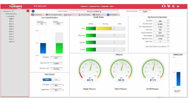

Figure 3: User-friendly, browser-based, device-specific dashboard. Courtesy: FDT Group
At the same time, FDT web services provides a standardized mobile access approach using browsers, apps, standalone applications or anything else capable of interfacing via web sockets.
