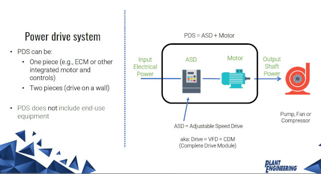

What are the advantages of using adjustable speed drives? The combination of a motor and adjustable speed drive (ASD) is called a power drive system (PDS). Specifying adjustable speed drives can help a manufacturing process become more energy efficient and productive. On variable torque applications (pumps and fans), one can expect energy savings of 20 to 40% with a PDS when compared to an application using a valve or damper for flow control.

Power drive systems (PDS), electronically commutated motors (ECM), adjustable speed drives (ASD) and variable frequency drives (VFD) were all highlighted in this webcast. Courtesy: Plant Engineering
