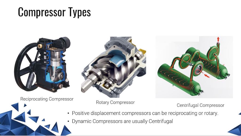

During the March 2023 webcast, the various types of compressed air systems were reviewed. Courtesy: Plant Engineering
