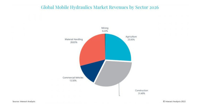

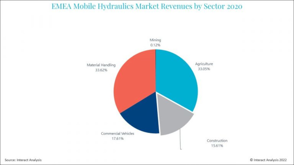

Despite electromechanical actuators being highly suitable for applications within the material handling sector, hydraulic sales to the sector are still rapidly growing. Sales of hydraulics within the material handling sector are projected to overtake agriculture by 2026. As a result, the material handling sector will become the second largest sector in the mobile hydraulics market. Much of this can be attributed to the rapid growth which is forecasted for forklift sales within warehousing applications over the next several years.

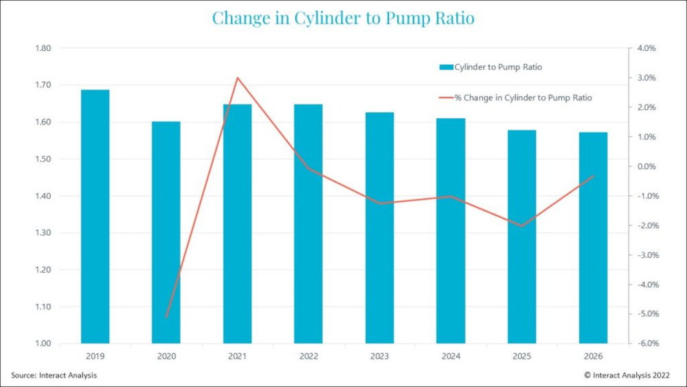

The question then becomes to what extent will electromechanical actuators penetrate the market and replace traditional hydraulic cylinders. In our research, we quantified the rate of total hydraulic replacement of cylinders through an analysis using a ratio of cylinders per pump in the market. To explain in greater detail, we estimated that for the entire market the number of cylinders per pump sold was 1.68 in 2019. However, we expect that ratio to decline to 1.57 by 2026. This represents an overall decline of -6.4% over the forecast period.
For the material handling sector, this decline in the number of cylinders per pump is even steeper at -8.8% over the forecast period. This would imply a greater rate of replacement in favor of electromechanical actuators within the material handling sector. This analysis should be taken with a pinch of salt as changes to the number of pumps will also impact the ratio. We do believe however, is that it’s directionally insightful and the results mirror what we heard during interviews with hydraulics suppliers and OEMs.
